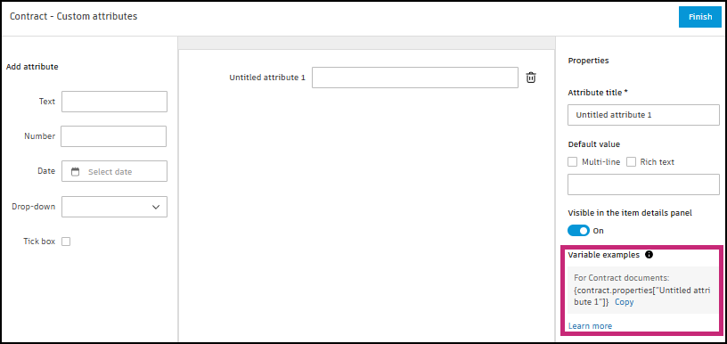

Some custom attributes generate custom variables that can be referenced in documents. However, not all custom attributes create custom variable entries. The following custom attributes support custom variables:
The format for these custom attributes is {xxx.properties["Attribute Title"]}.
If you have a date custom attribute for an RFQ titled ‘Required on Site’, you would reference it as {rfq.properties["Required on Site"]}. This will return the specified date.
