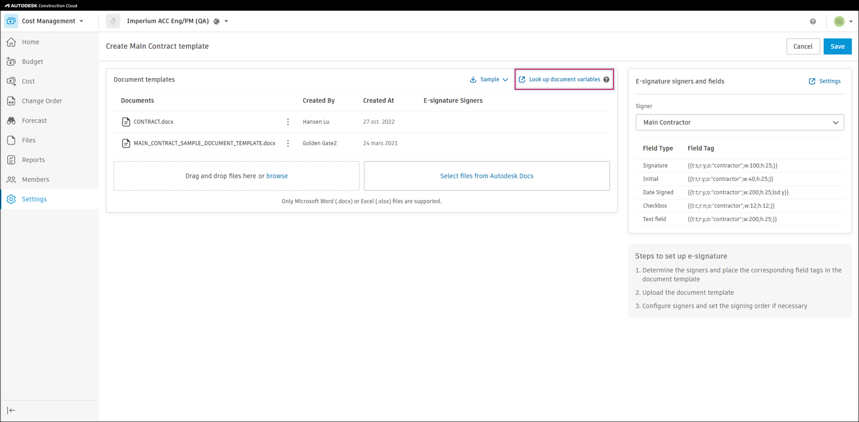

To access the Variable Finder for document template settings, follow these steps:
Go to Settings.
Select the tool for which you want to edit the template. For example, Budget or Main Contract.
Click Edit.
The template creation tool will open. Here, select ‘Look up document variables’ in the upper-right corner.
After clicking, the ACC Cost Management Variable Finder will open in a pop-up window.

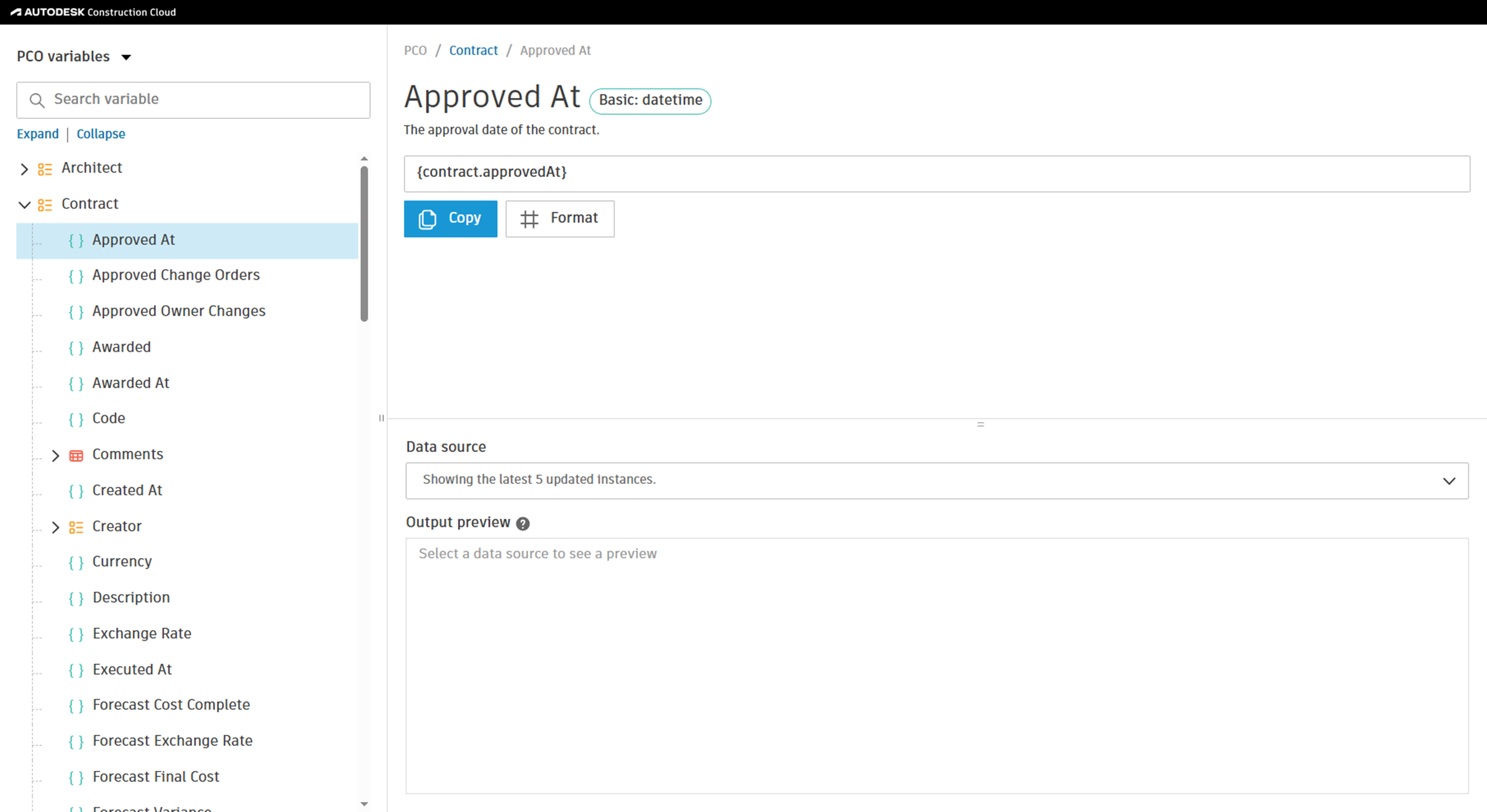

The Variable Finder is divided into three main areas: Tree Area, Details Area and Preview Area.
The Tree Area allows members to navigate through the variable structure. Members can adjust the width of this area by dragging the handle.
Variable Finder Title: Click the drop-down to switch between different modules.
Search Box: Members can search for variables in three ways:
Details Area provides specific information about the selected variable.
The Preview Area allows members to see how the variable will appear with actual data.
