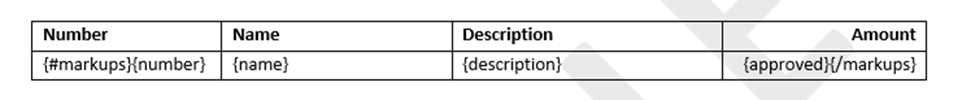

How can I add a table with variables?
You can use variables and present your data in the form of a table with columns and headers. Here's an example of syntax:
Example of table variable syntax showing opening and closing markup variables
Use the opening section variable, starting with # (for example, {#markups}) and closing one with / (for example, {/markups}).
Note: Don't repeat the same opening and closing variable in one table.

Between opening and closing variables, you can list all the necessary data, like {name} or {description}.
Table variable syntax example with name and description variables

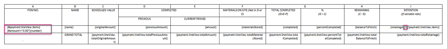

How to remove empty line items from a payment application?
To remove empty line items from a payment application use the conditional expression {#amount!="0.00"} at the beginning of a table and {/} at the end of the line. For example:
Example of conditional expression to remove empty line items from payment applications

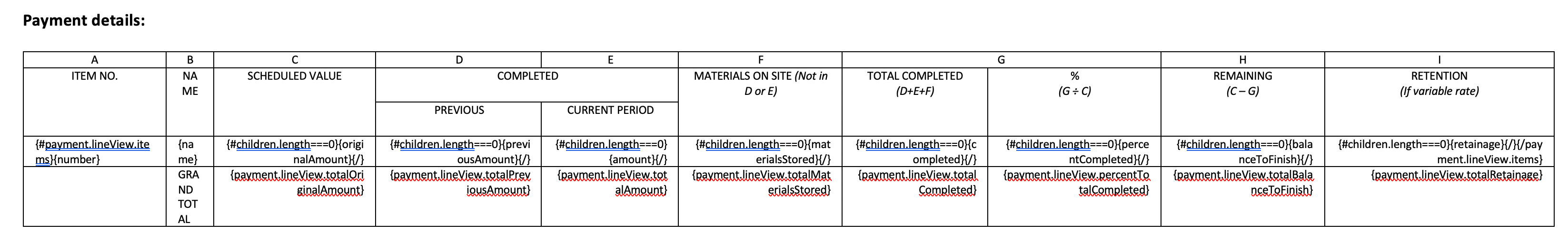

How can I only show costs on scheduled items and not show subtotal amounts in payment applications?
To eliminate subtotals from payment applications or contracts, you can enter your payment line items with {#children.length===0}{xxx}{/}. For example:
Example showing how to eliminate subtotals using children.length condition

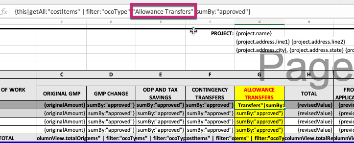

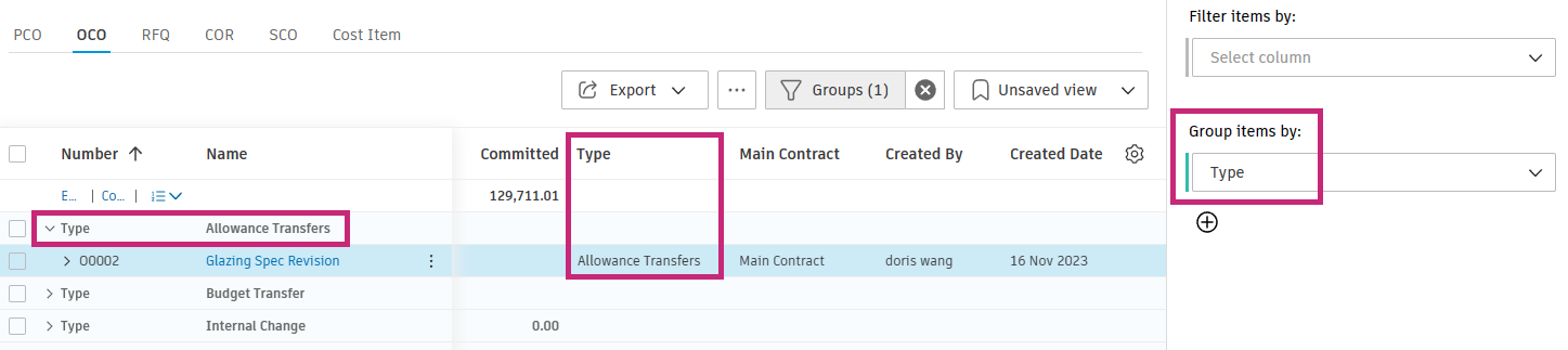

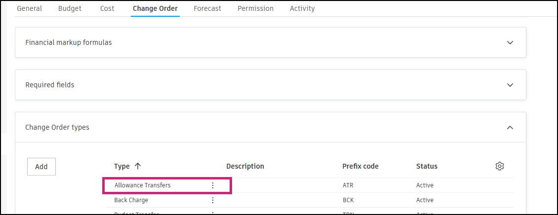

How can I configure the budget payment application spreadsheet to split change orders by type?
Scenario: You have created a change order type called ‘Allowance Transfers’.
Change order type setup showing Allowance Transfers configuration
And want to see the approved owner changes for these allowances in the Excel spreadsheet. How to do that?

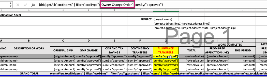

  1. List ‘Owner Change Order’ for the column in the Excel spreadsheet.
    Excel spreadsheet showing Owner Change Order column setup
  2. Apply the new type to an OCO.
    OCO with Allowance Transfers type applied
  3. Match the name to the type in the Excel spreadsheet.
    Excel spreadsheet showing matched type name configuration

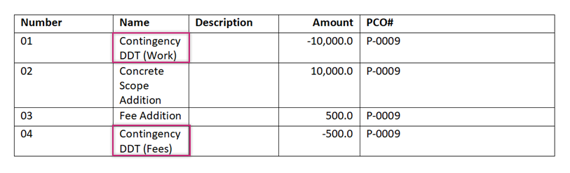

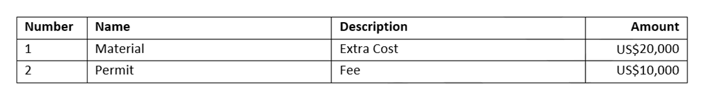

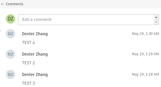

How can I add the content from the comments section to change order documents?
Scenario: You want to create a document containing the comments added throughout the lifetime of a change order.
The example shows {#rfq.comments} as the opening tag for the variables and {/rfq.comments} as the closing tag. The other related variables must be between these two variables.
For example, an RFQ with the following comments section:
RFQ comments section showing multiple comment entries
Adding a table into a Word document with the following:
Word document template showing RFQ comments variable syntax
Results in:
Generated document output showing formatted comments table

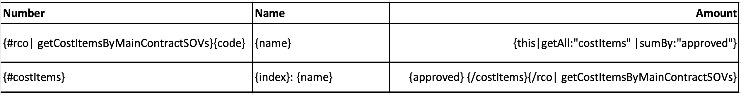

How can I organise upstream change orders by the main contract SOV?
To organise CORs or OCOs by the main contract's Schedule of Values in your document template. For CORs, use this pattern:
Variable pattern for organizing CORs by main contract Schedule of Values
And for OCOs, replace rco with oco.

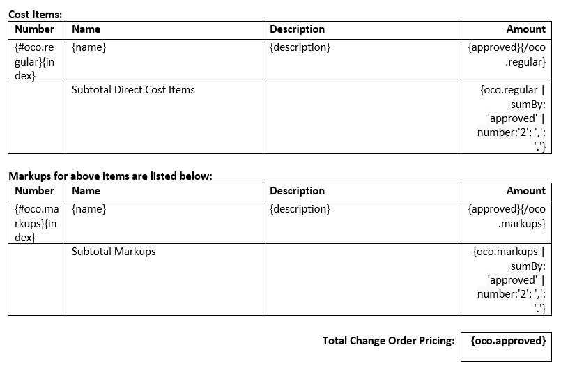

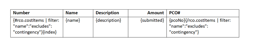

How can I add work item subtotals and markup subtotals for cost items?
Scenario: You're creating a change order document (for example, OCO) and want to have two separate tables within. one for regular cost items with a subtotal and the second for markup cost items. You want to add total change order pricing as well. How to do that? Here's an example of used variables in a document:
OCO document template showing separate tables for work items and markup subtotals

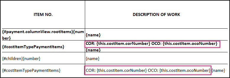

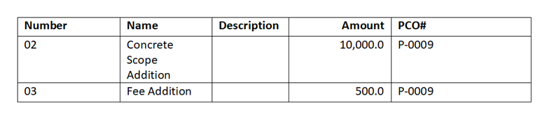

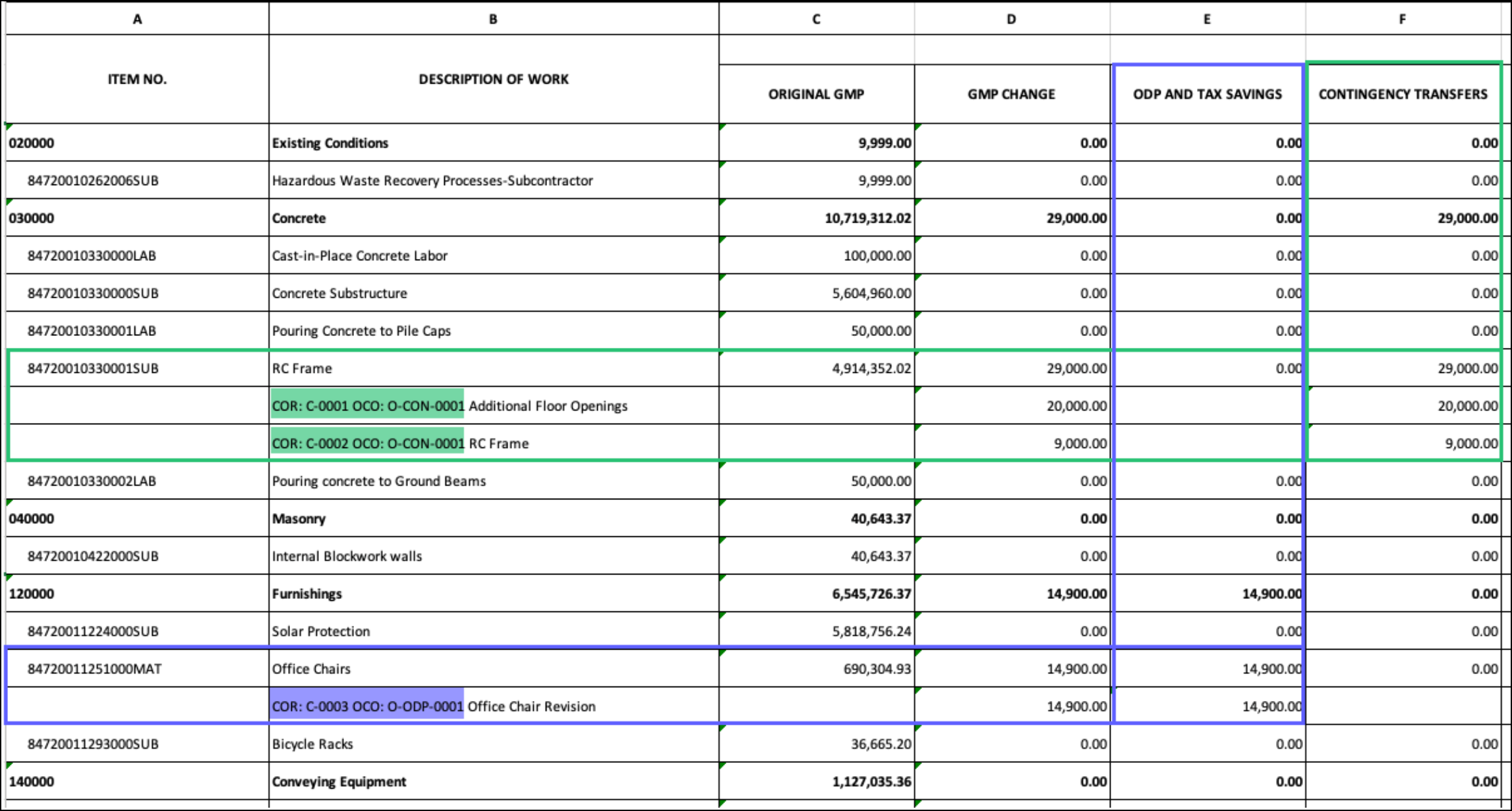

How can I show associated COR and OCO numbers when splitting change orders by type?
To show associated COR and OCO number use the following variables:
Document template showing COR and OCO number variables
The result:
Generated document showing COR and OCO numbers in change order table

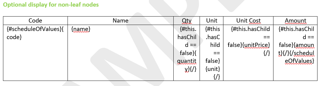

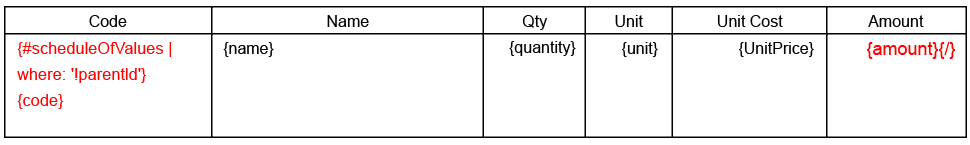

How can I only show costs on scheduled items and not show subtotal amounts in contract SOV?
Scenario: You want to create a contract with only the subtotal of SOV subitems displayed. You don't want a parent item to be visible to a subcontractor. To do that, use these variables from the document template:
Document template showing child variable syntax for SOV subitems
Also, you don't want to show the Unit Cost and Amount values as $0. You can replace $0 with the word ‘Included’. How to do that? Enrich already-used variables:
Enhanced child variable template replacing $0 values with 'Included'
The outcome in the generated contract will look like this:
Generated contract showing SOV subitems with 'Included' replacing $0 values

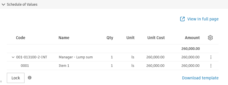

How can I refer to the budget code and name in contract document templates?
To refer to a budget code and name in the document template, use this formula:
Document template formula for referencing budget code and name
For example, when the Schedule of Values for the contract looks like this:
Contract Schedule of Values showing budget code structure
The presented formula generates this:
Generated document output showing budget code and name formatting

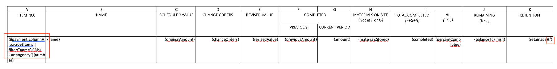

How to use filter functionality on document generation?

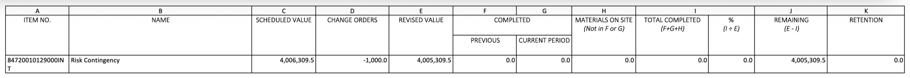

You can use filter functionality on document generation. For example, to only show the Risk Contingency item, use the {#payment.columnView.rootItems | filter:"name":"Risk Contingency"} variable:
Document template showing filter functionality for Risk Contingency items
Result:
Generated document showing filtered Risk Contingency results
