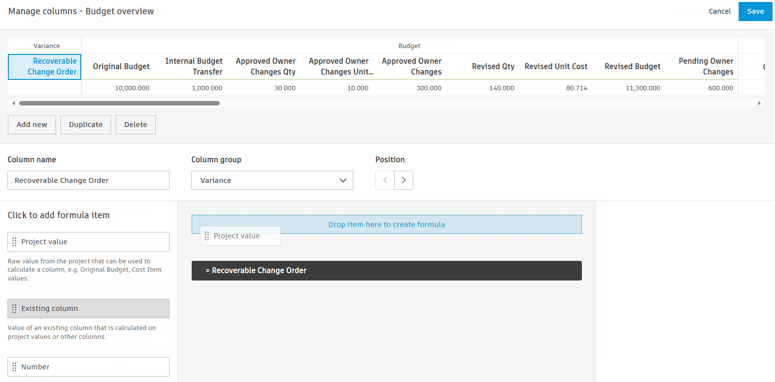

  8. From the left side panel, drag a formula item and drop it to create a formula.
    Screenshot showing the column formula builder interface with draggable items including Project Value, Existing Column, Number, Parentheses and If Statement on the left panel

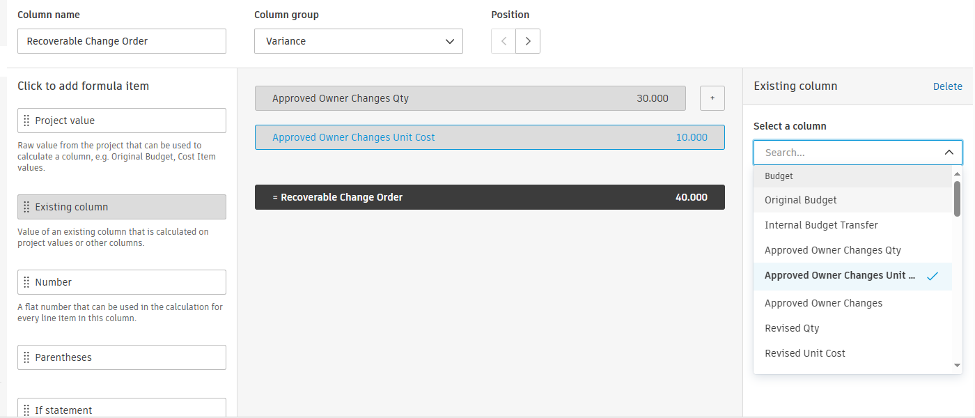

  9. On the right side panel, select the value type and enter a value to preview.
    Screenshot of the right side panel displaying value type selection and preview value input field

You have created the Recoverable Change Order column. There are many possibilities and combinations to create columns. See the Custom Calculated Columns Equations section to see helpful tips and tricks on how you can create equations to suit your company's needs.

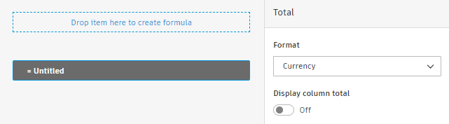

Tip: You can choose if you want your total to be visible as currency, a number or a percentage. Click Untitled in the centre column.
Screenshot showing the column total configuration options with currency, number and percentage display formats
Note: Once you choose to display a total column, you can pick whether the column should use the sum of all rows or a defined formula.
