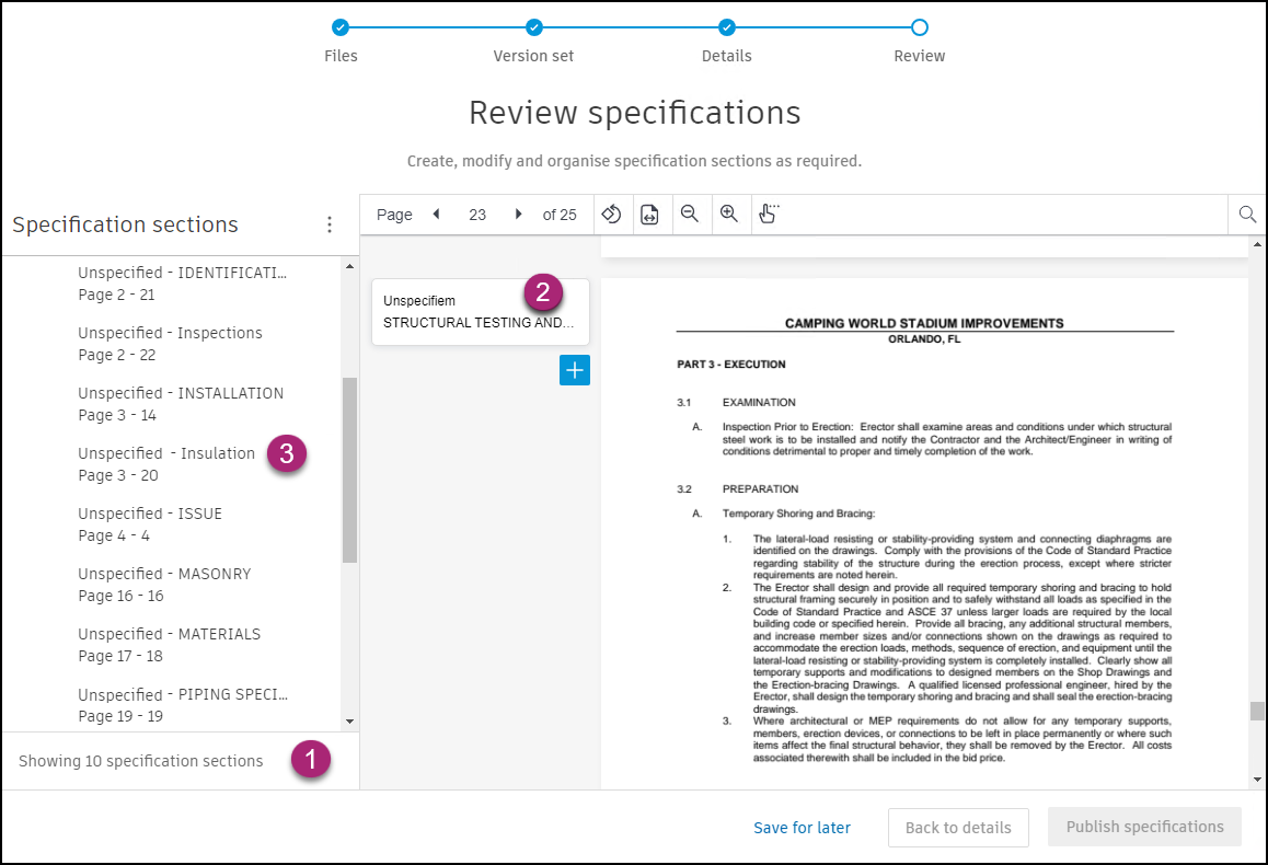

In addition, note the following:

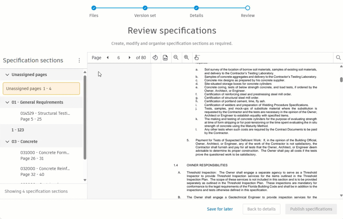

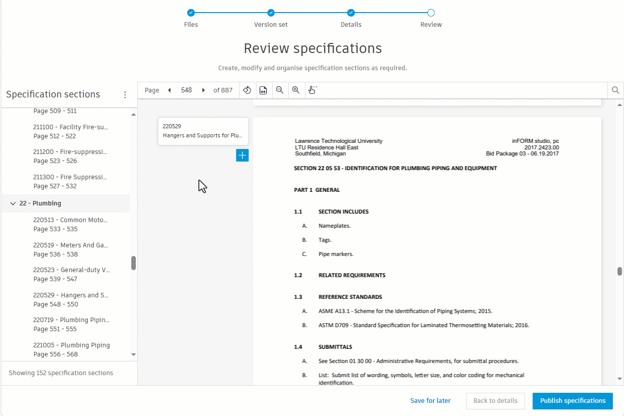

1: The total identified sections are displayed at the bottom left.
2: Section markers indicate start pages of automatically generated sections and deliver information about section codes and descriptions. See Edit Specification Sections for details.
3: When you select the Other/Unknown specification format type, sorting is initially alphanumeric. If no code is found or added, sections are sorted by page numbers.

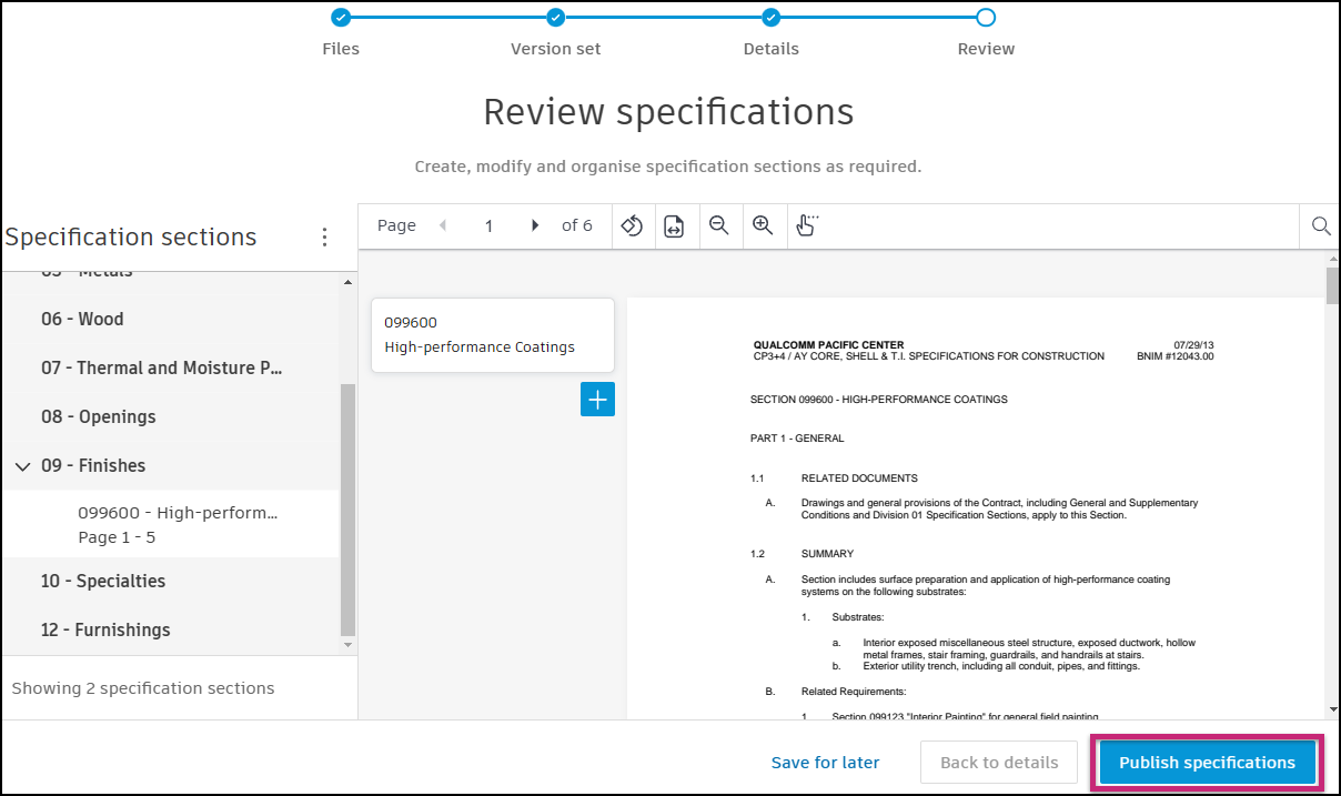

Add Specification Sections
Learn how to handle unassigned specification pages and add specification sections.

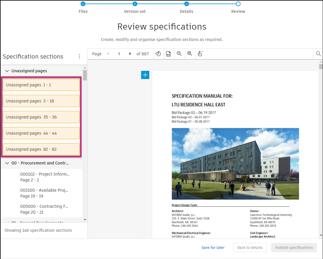

Unassigned Specification Pages
Every page must belong to a specification section, or be marked as ignored, before you can publish. See Handle Unassigned Specification Pages.

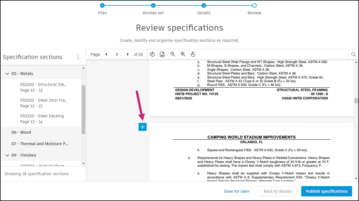

Adding Specification Sections
As you scroll through the specification, you can use the blue Plus button displayed at the beginning of each page to add sections.
  1. Click .
  2. In the Add section flyout panel that opens on the right:
    a. Optionally, enter a code for the section you're adding.
    Note: If you do not specify a section code, the code appears as Unspecified on the Specifications home page.
    b. Enter a description.
    c. Optionally, select a parent specification group to assign the section to.
    d. Enter a start page and end page for the section.
  3. Click Add.
    Tip: You can add a maximum of six sections on one page.

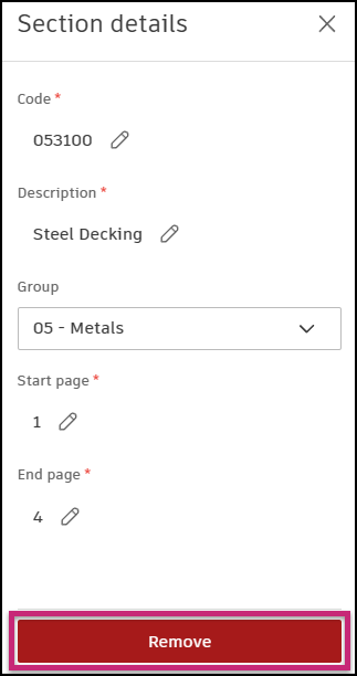

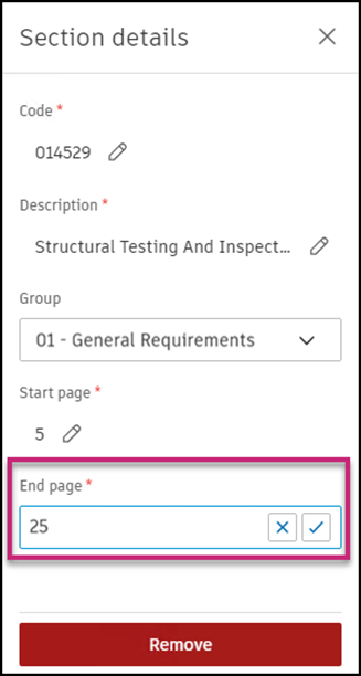

To edit a section, click a section marker, and make desired changes in the Section details flyout panel on the right.
Remove Specification Sections
Note the following considerations:
There are two ways to remove specification sections.
Remove Sections Using a Section Marker
  1. Click the section marker for the section that you want to remove.
  2. In the Section details flyout panel on the right, click Remove.
  3. When prompted, confirm your choice by clicking Remove.

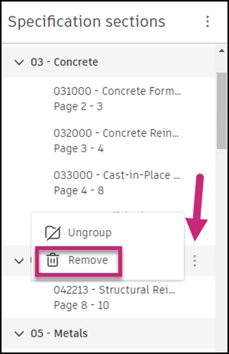

Remove Sections from the More Menu
  1. In the Specification sections panel on the left, click the More menu next to the section that you want to remove.
  2. When prompted, confirm your choice by clicking Remove.
    Remove Sections from More Menu
Tip: You can separate specifications that have been grouped by clicking Ungroup from the More menu .

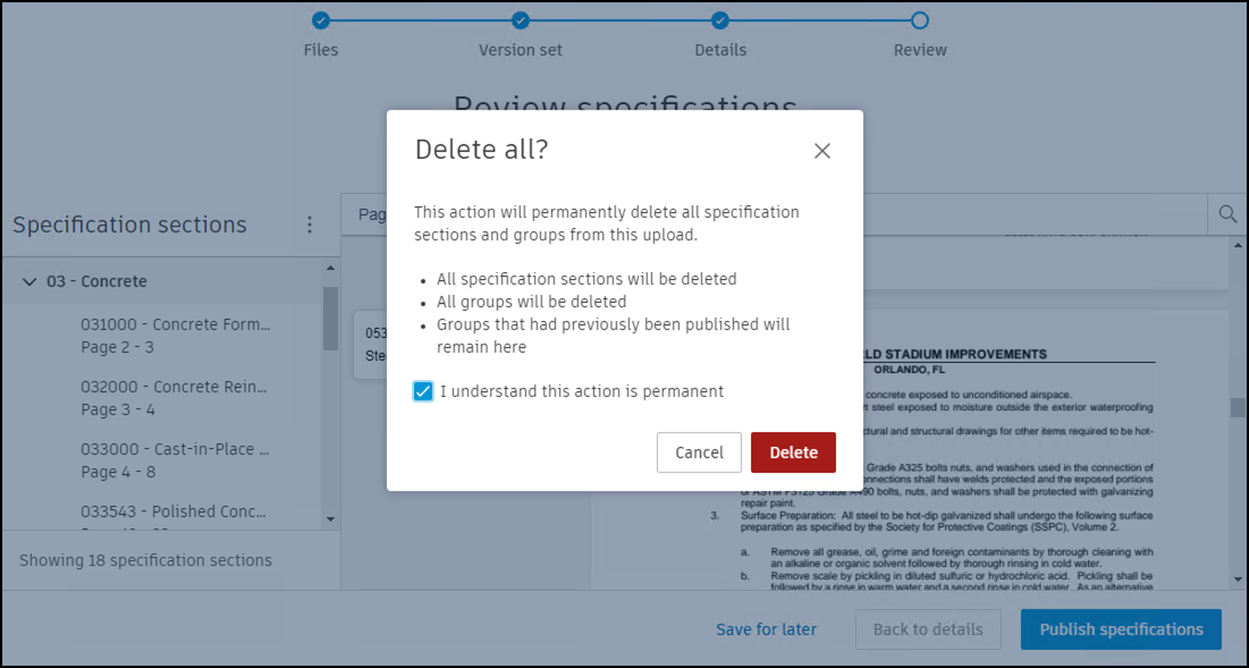

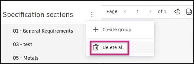

Delete All Specification Sections
To permanently delete all specification sections and groups from an upload:
  1. Click the More menu next to Specification sections in the panel on the left.
  2. Click Delete all.
  3. Tick the I understand this action is permanent box at the bottom of the modal to confirm you want to delete all sections.
  4. Click Delete.

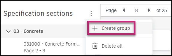

Create Specification Groups
To organise your specifications, you can create specification groups to make documents that are conceptually, topically or otherwise similar, easier to find.
  2. Click Create group.
  3. In the Create group modal that opens:
    a. Enter a code and description for your specification group.
    b. Optionally, select specification sections to include from the drop-down menu.
  4. Click Create.

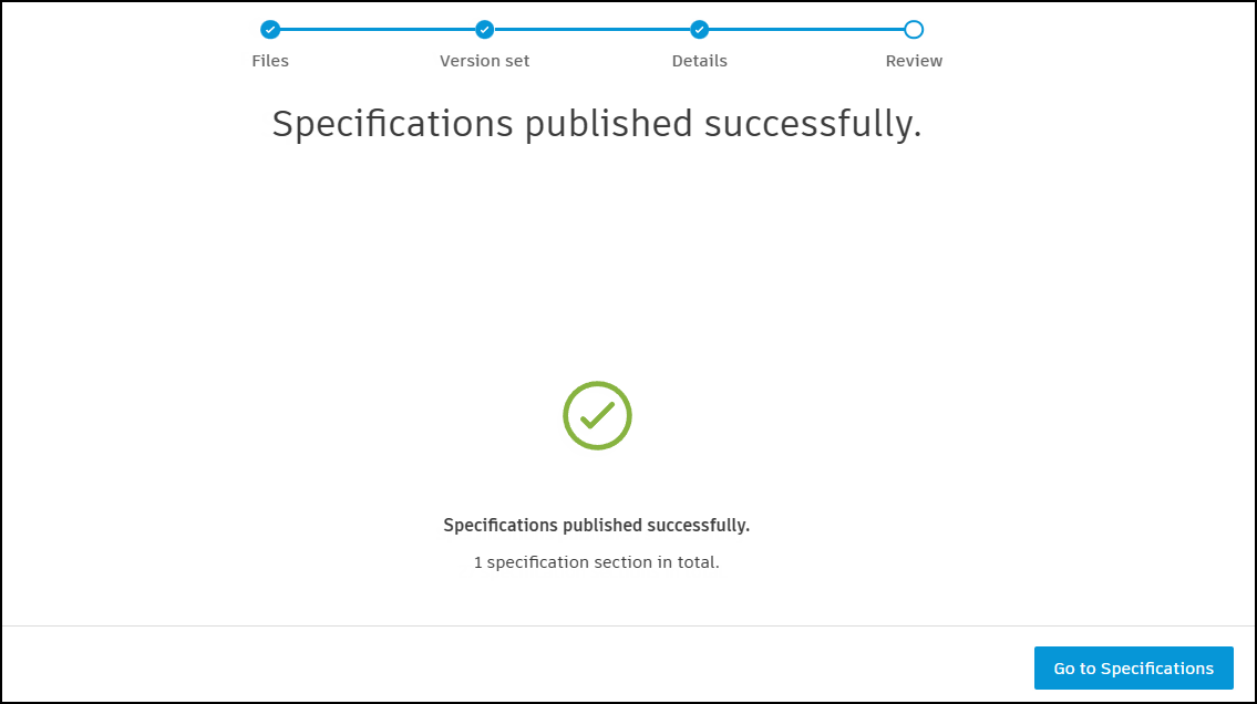

  5. When you have entered all section information correctly, click Publish specifications.
  6. On success, you will see the following screen:
  7. You can also save your progress and continue publishing later by clicking Save for later. Your specifications will be saved in the Publish Log, where you can continue the publishing process later.
  8. Click Back to details to return to the step where you can choose a format and project location.
