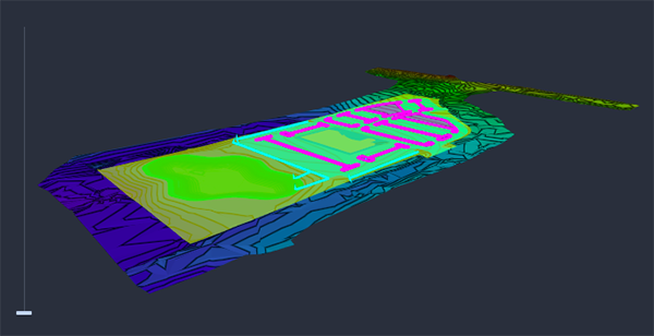

For example, this site is unexaggerated and has elevations ranging from 1430 to 1485 metres. It is difficult to see some of the subtle elevation changes.

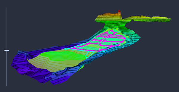

This is the same view exaggerated.
While it is not a realistic view, it more clearly shows the changes that occur in elevation.
Note: Exaggeration does not affect the optimisation. It is simply changing the perspective of what you see.
