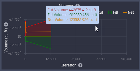

The Volumes chart of the Convergence Plot Analysis dialog has been updated to better clarify the Balance Cut and Fill objective.

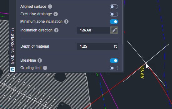

When placing zones in a drawing, you can now use the Inclination Picker tool to specify the Inclination Direction of the Minimum Zone Inclination.

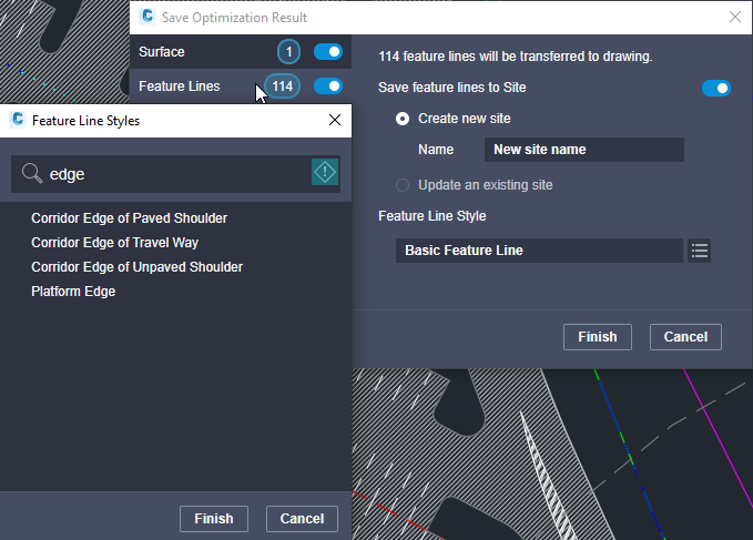

The Save Optimisation Result dialog has been improved to include searchable selection dialogs for surface, feature line and point styles.
