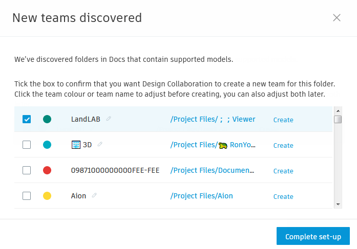

Click the link in the notification, or click to scan for new teams, and then use the New teams discovered dialog box to specify how the teams should be set up:
  1. Click on the tick box next to the folder name to create a team for that folder.
  2. Click the colour dot and select a new colour from the palette.
    Note: This colour is used on the timeline, and can be used to highlight a team's models when viewing the aggregated Project Model.
  3. Click on the pencil icon next to the folder name to edit the name, then click on the tick to save. The name you enter here will be the name of the team. It does not have to match the name of the folder.
  4. Click Complete setup to create the team.
