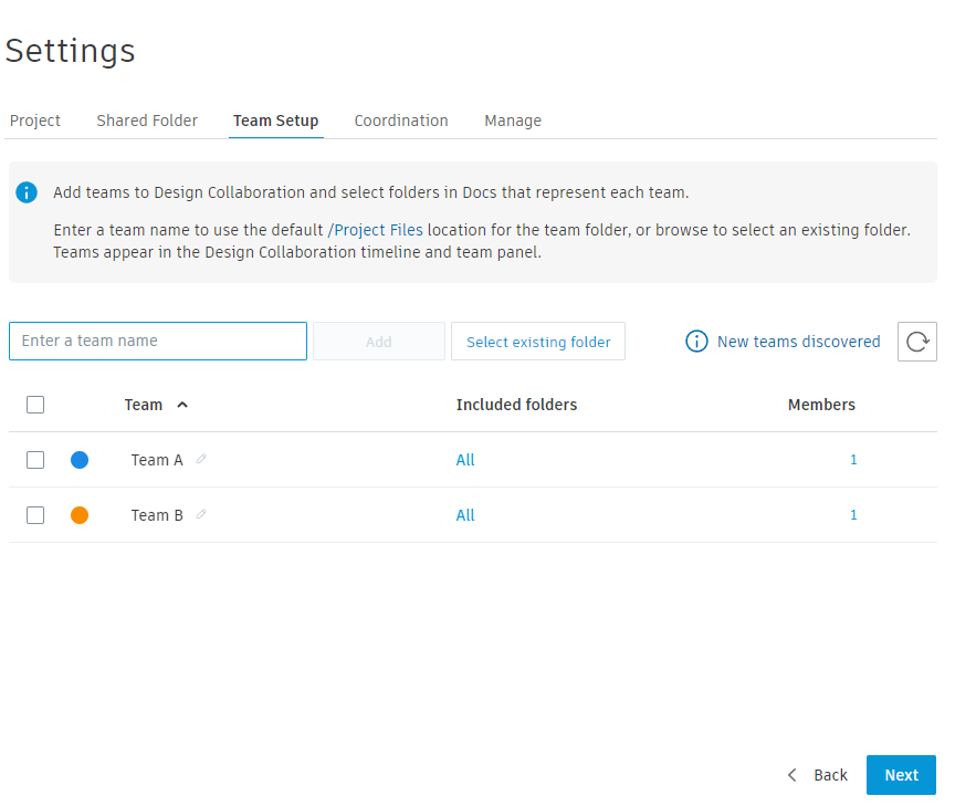

Before adding teams and managing team members, it’s important to understand what happens between Design Collaboration and the Files tool (in Autodesk Docs or Build) when a team is added. To do this, consider the following example in which two teams were added; Team A and Team B.

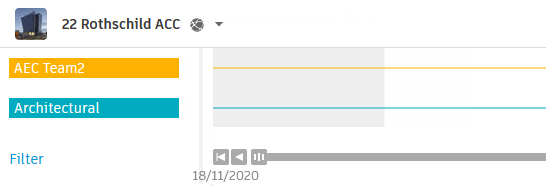

We see the two teams on the project timeline in Design Collaboration:

All of these folders are created when you add teams using the Settings tool for Design Collaboration. The shared folder and its subfolders for each team represent the shared space for all teams. The consumed folder and its parent team folder represent the Team Space for each individual team.
