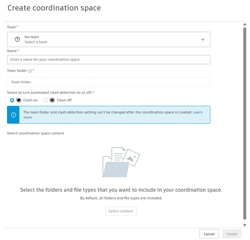

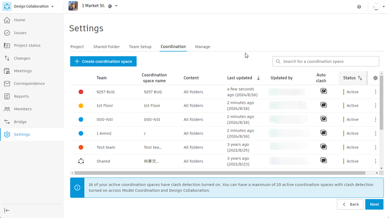

  1. Click the Settings tool > Coordination tab.
  2. Click Create coordination space.
  3. Select the team that you want to create this coordination space for. You can also create a coordination space against the Shared folder.
    Important: The Team folder field displays the root folder path for the coordination space based on your team selection. The root folder can't be changed later.
  4. Enter a name for the coordination space.
    The team name is used as the coordination space name by default, but you can rename the space without changing the team folder name.
  5. Specify whether you want automatic clash detection turned on or off.
    Important: The automatic clash detection setting can't be changed later.

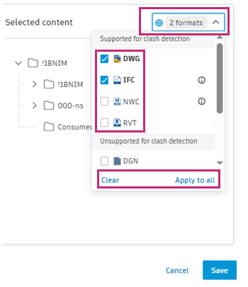

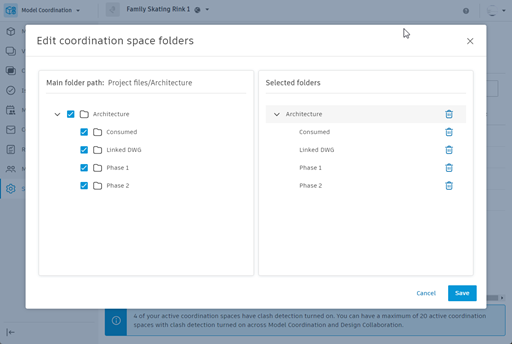

  6. Click Select content to open the Edit coordination space content dialog, and choose which content you would like to include in the coordination space.

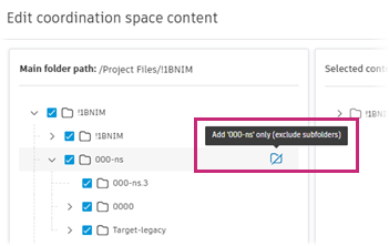

    1. By default, all folders in the Main folder path panel are selected to be included. Expand the folder tree to deselect any subfolders that you don't want to include the content from. You can also explicitly select a parent folder, which automatically deselects all its subfolders:
      Note: The folder structure is not replicated in the coordination space. All models from the selected folders will be listed alphabetically in a single, flat repository structure in the Models tool.
    2. In the Selected content panel, select the file formats that you want to include.
      Tip: By default, no file formats are selected in the drop-down lists. This corresponds with all file formats being included for all folders, as indicated by the All formats label. When you select file formats to be included specifically, the deselected formats are filtered out.
      • Use the drop-down list at the top right to select the required file formats for all included folders. This global setting applies to all parent folders and all subfolders unless overridden (see step 2 below).
        1. Click Clear to deselect all file formats and return to the default All formats setting.
        2. Click Apply to all to apply the selected file format settings to all folders as the global setting.
        Note: The global file format setting is not tied to the main coordination space folder. It applies to all the selected folders and subfolders, even if the main folder itself has not been selected for inclusion. If you change the global setting, this change is automatically applied to all folders that inherit that setting.

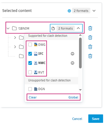

      • Use the drop-down lists next to each folder to specify the required file formats at the individual folder level.
        2. Click Global to apply the global setting to the selected folder.
        Note: By default, subfolders will inherit file format settings from their parent folder. However, the ability to apply folder-level settings means that a parent folder and its subfolders can have different settings applied, and that the global setting can be overridden for specific folders as needed.
