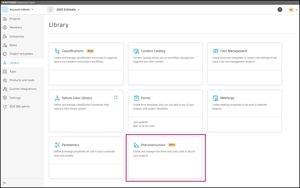

  1. Select Account Admin from the product picker dropdown at the top left of the page in ACC.
  2. Click Library in the left navigation.
  3. Click the Preconstruction card to open the Preconstruction library page.

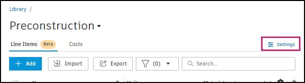

  4. Click the Settings link at the top right of the list to open the Settings page.

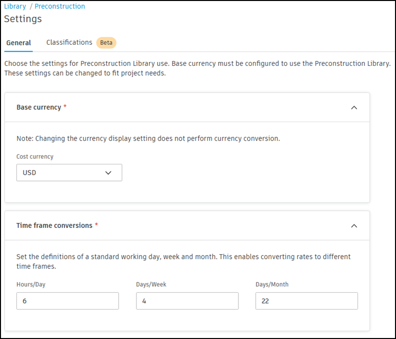

  5. By default, the General tab will open.
  1. Set base currency and time frame conversions. Base currency and time frame conversions are required in order to use the Preconstruction Library.
    • Base currency – Select the currency that library items will display.
      • Changing the currency display setting does not perform currency conversion.
      • The Preconstruction cost library is limited to a single base currency.
    • Time frame conversions – Set the definition of a standard work day, week
      and month. This enables conversion rates to different time frames.

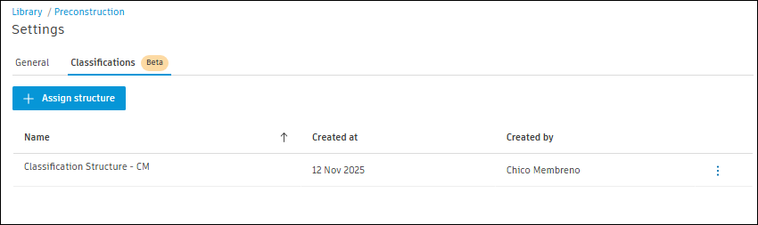

  5. Click the Classifications tab to open Classifications settings.
  1. Click +Assign structure.
  2. In the Select classification structure modal, select up to 5 classification structures from Library to make them available in the Preconstruction Library.
  3. Click Add.
    The assigned library classifications will now be available to items in your Preconstruction Library.
