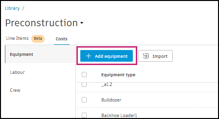

To enter a cost into Preconstruction Library:
  1. Select Account Admin from the product picker dropdown at the top left of the screen.
  2. Click Library in the left navigation.
  3. Click on the Preconstruction card to open the Preconstruction library page.
  4. Click the Costs tab to open the Costs page.
  5. Select either Equipment, Labor, or Crews in the Costs left navigation to open that category list.
  1. Click +Add to add a cost to a category.
  2. Complete the details for each cost.

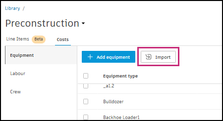

Your organisation may already have its own cost estimating databases or spreadsheets. If so, you can import this cost data into Autodesk Estimate using the XLSX import workflow. This process can help you quickly set up your account’s cost library without having to start from scratch.
To import costs using an XLSX to Preconstruction Library:
  5. Select either Equipment, Labor, or Crew in the Costs left navigation.
  1. Click Import.
  2. Follow the onscreen workflow to download and complete the XLSX template for the type of cost you selected.
    • Read and follow the instructions in the template to correctly format the costs in the XLSX file before uploading.
  3. Upload the completed XLSX file with your costs.
  4. Correct any errors that occur, then upload the corrected file.

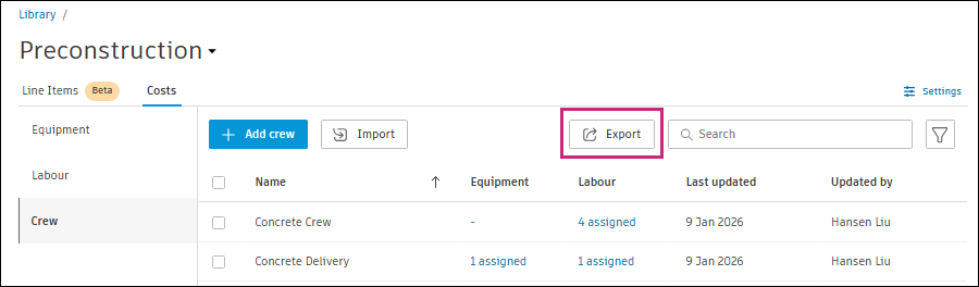

To export costs from Preconstruction Library:
  1. Click Export to export and download the selected Costs library list to a spreadsheet.
