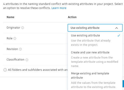

When you are creating or importing a naming standard, you need to resolve any conflicts between existing custom attributes and those in the naming standard. A conflict arises when:
An attribute in the imported naming standard has the same name as an existing attribute but a different description, type, constraints or values.
An imported naming standard attribute is set as Uniclass and an existing attribute is already set as Uniclass (even if the attributes have different names)
Use existing attribute: Use the attribute which already exists in the project instead of the conflicting attribute in the new naming standard.
Overwrite existing attribute: Overwrite the existing attribute with the details and values of the new naming standard attribute.
Create and use new attribute: Create a new attribute by copying the new naming standard attribute and giving it a modified name.
Merge existing and template attribute: Add the values from the new naming standard attribute to the existing attribute.
