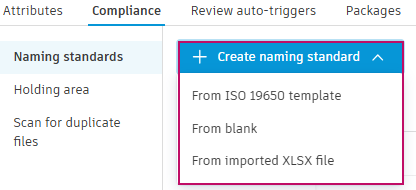

  5. Click Create naming standard.
    There are several options to create a naming standard.

From ISO 19650 Template
After you've clicked Create naming standard:
  1. Click From ISO 19650 Template to see a preview of the default naming convention and related attributes.

From blank
You can create a naming standard entirely from scratch. After you've clicked Create naming standard:
  1. Click From blank.

From imported XLSX file
You can export a naming standard from one project and import it into another project. You can also download, edit and save the naming standard template before importing and applying the edited template to a project.
