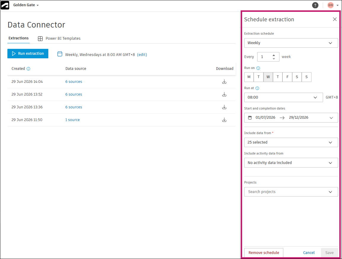

Schedule Extractions
You can automate regular data extractions by using scheduling.
  1. Click Schedule.
    This opens the Schedule extraction flyout panel on the right.
    You can edit the following fields:
    • Extraction schedule: Select Daily, Weekly or Monthly
    • Every: Select the number of days, weeks or months
    • Run on: Select the date that you want the schedule to run on
    • Run at: Select the time
    • Start and end dates: Select the start and end dates
    • Include data from: Select the tools for which you want to extract data
    • Include activity data from: Select the tools for which you want to extract activity data
  2. Click Schedule.
Edit Data Connector Schedule
To change or delete the schedule, click edit. Edit the schedule and click Save or click Remove schedule to delete the schedule.
Refer to Data Connector Autodesk Platform Services API to learn how to schedule the extractions to run multiple times a day, or if you need to automate the data extraction process end to end.
