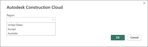

  8. Select which data storage region you want to connect to.
  9. Click OK.

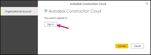

    You now need to sign in with your Autodesk credentials.
  10. Click Sign in.
  11. Sign in with your Autodesk credentials.
  12. Click Connect once you're signed in.

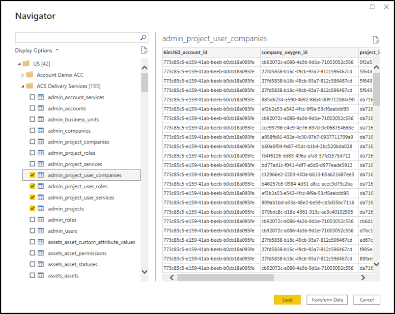

  13. In Navigator, expand the hub you want to pull data from, select the desired tables and then either select Load to load the data or Transform Data to continue transforming the data in the Power Query editor.

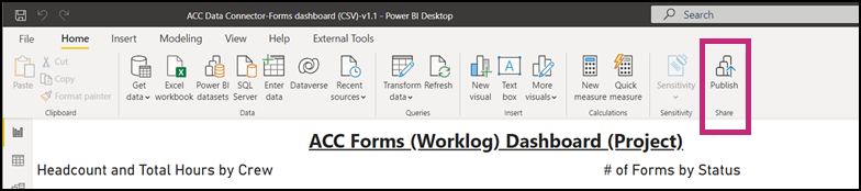

  2. Open Power BI desktop and click Publish.

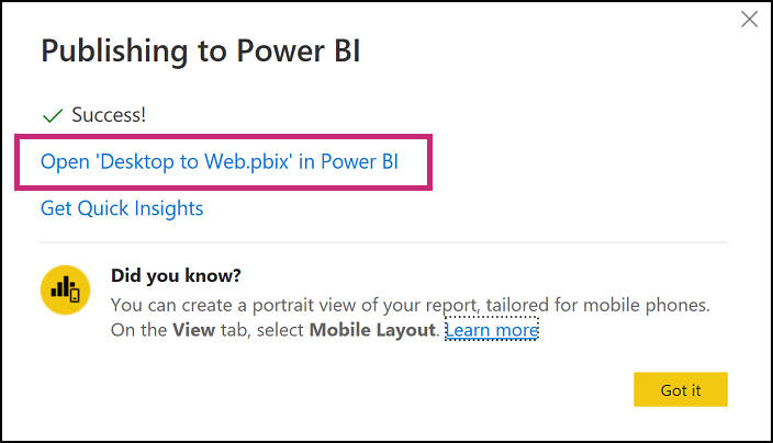

  6. After the file has finished being published, click the link in the dialog box or go to https://app.powerbi.com/.

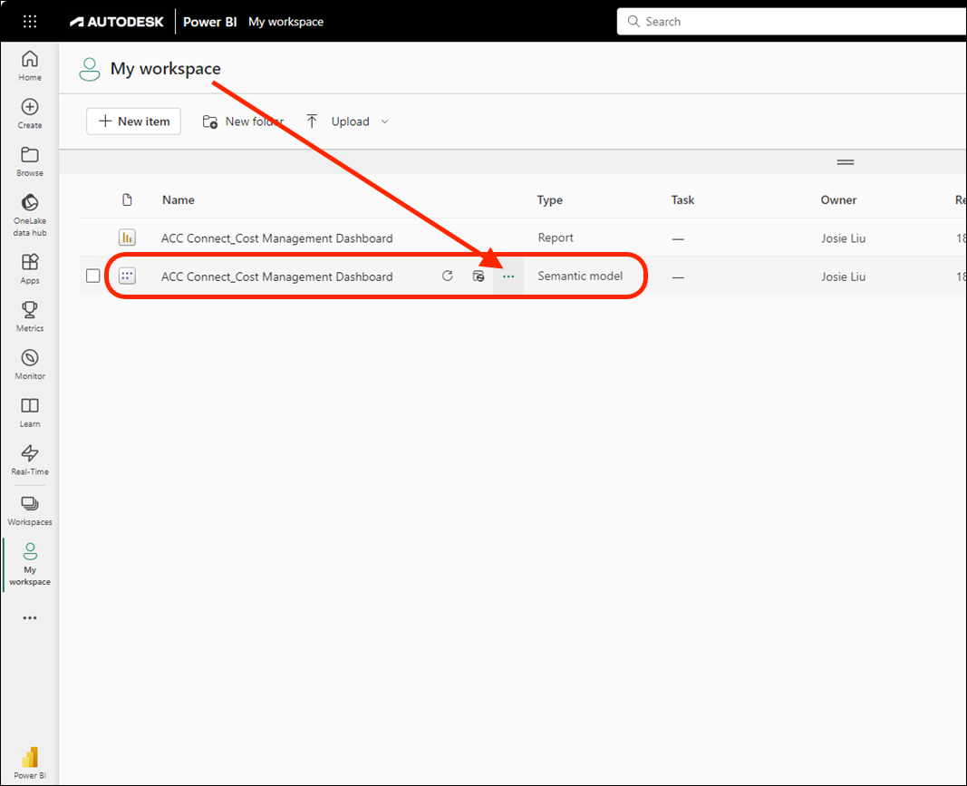

  7. Click Workspace on the left-hand side of Power BI web and select the workspace you published your file to.

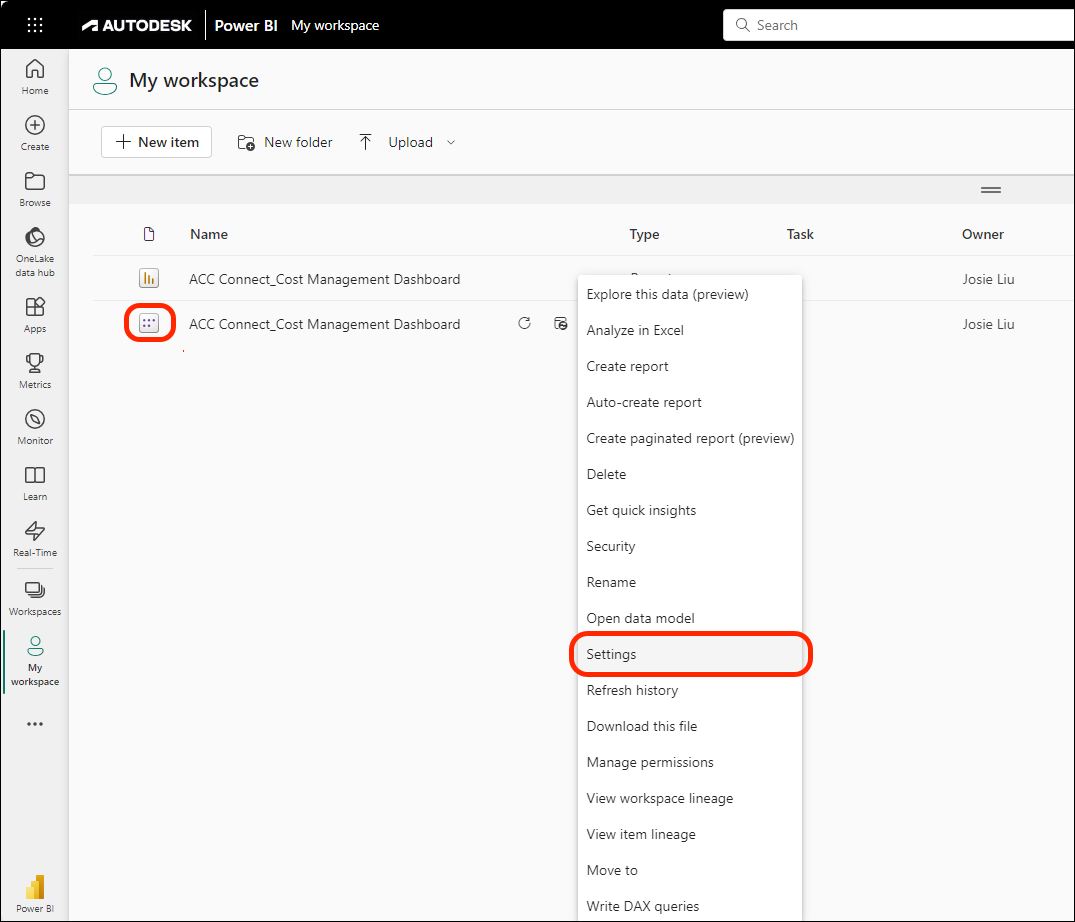

  8. Hover the cursor over the Semantic model with the same name as your Power BI file and click the More menu .

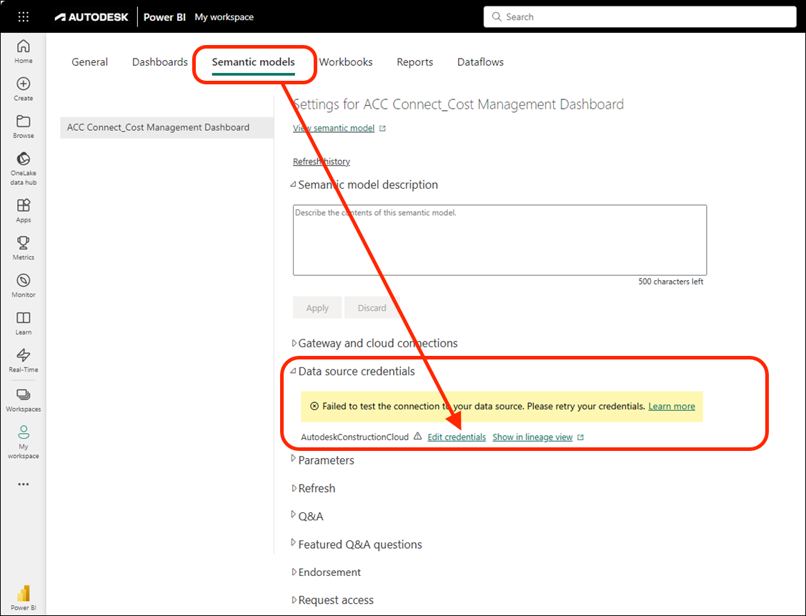

  9. Click Settings.
  10. Expand Data source credentials and click Edit credentials.
  11. Sign in with your Autodesk credentials to allow the Power BI web service to refresh your data.

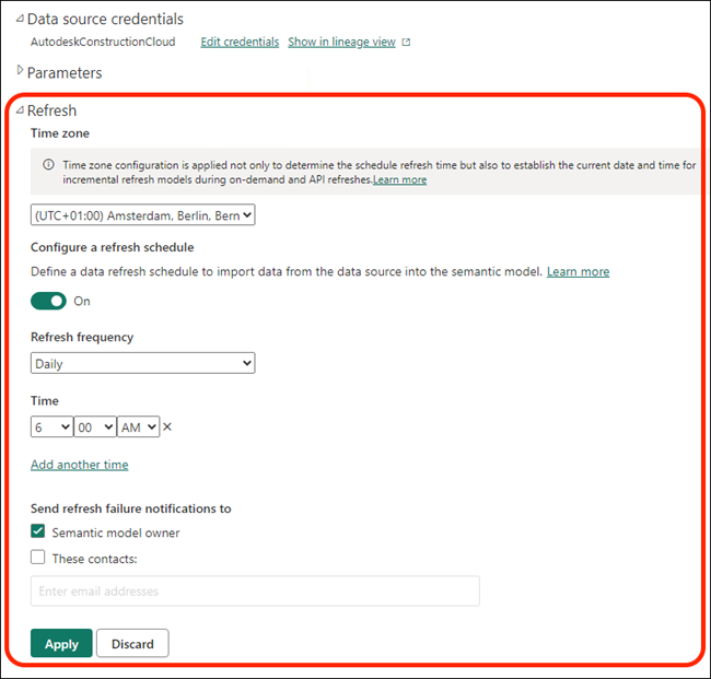

  12. Expand Refresh and toggle it on.
  13. Set up your Refresh frequency, Time zone, Time and any additional settings.
    Note: Allow a few hours delay between the scheduled extraction time in step 1 above and the Time of your Power BI scheduled refresh.
  14. Click Apply.
