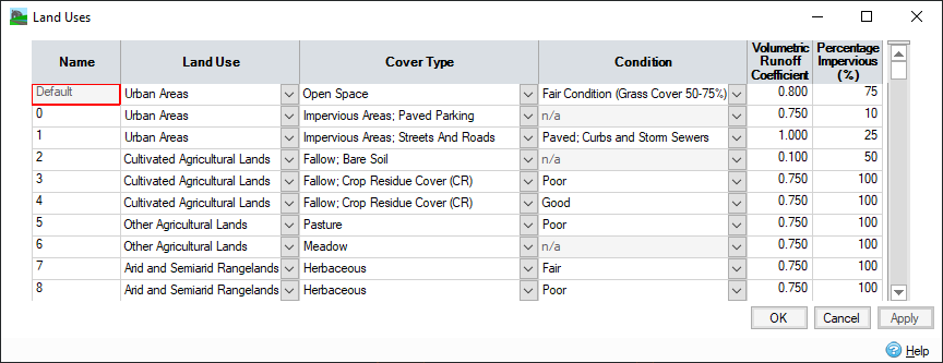

Land uses
Land Use areas and values are used to calculate weighted averages for catchment areas.
Name – The name of the Land Use.
Land Use – The primary category of the land use. Urban Areas, Cultivated Agricultural Lands, Other Agricultural Lands, or Arid & Semiarid Rangelands.
Cover Type – The specific type of cover on the land use. Options available depend on Land Use.
Condition – The hydrologic condition of the land use. Options available depend on Cover Type.
Volumetric Runoff Coefficient – Used to factor the runoff of an inflow when certain runoff methods are selected.
Percentage Impervious – The impervious portion of the land use.
The top row of the table provides the Default Land Use properties that will be used by all areas of inflows not covered by any Land Use in the design.
