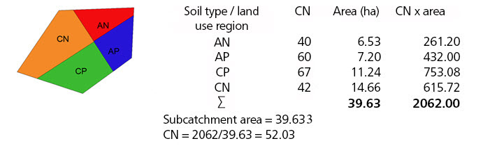

Where soil types are also considered the same calculation is used, where each area considered is the overlapping area of the catchment area with both a land use and a soil type.
This is used to calculate the Pervious Area Curve Number property for the SCS, Santa Barbara Urban Hydrograph and SWMM runoff methods.
