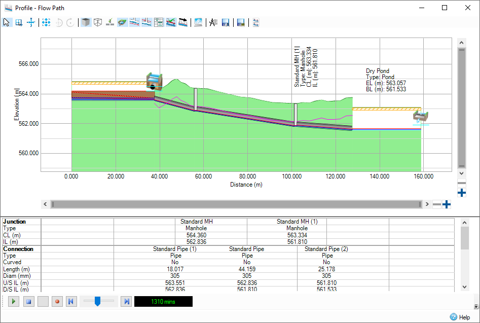

Viewing a Profile
To view the Profile for a given Path either double-click the Path in the Tree View or right-click and select View Path.
