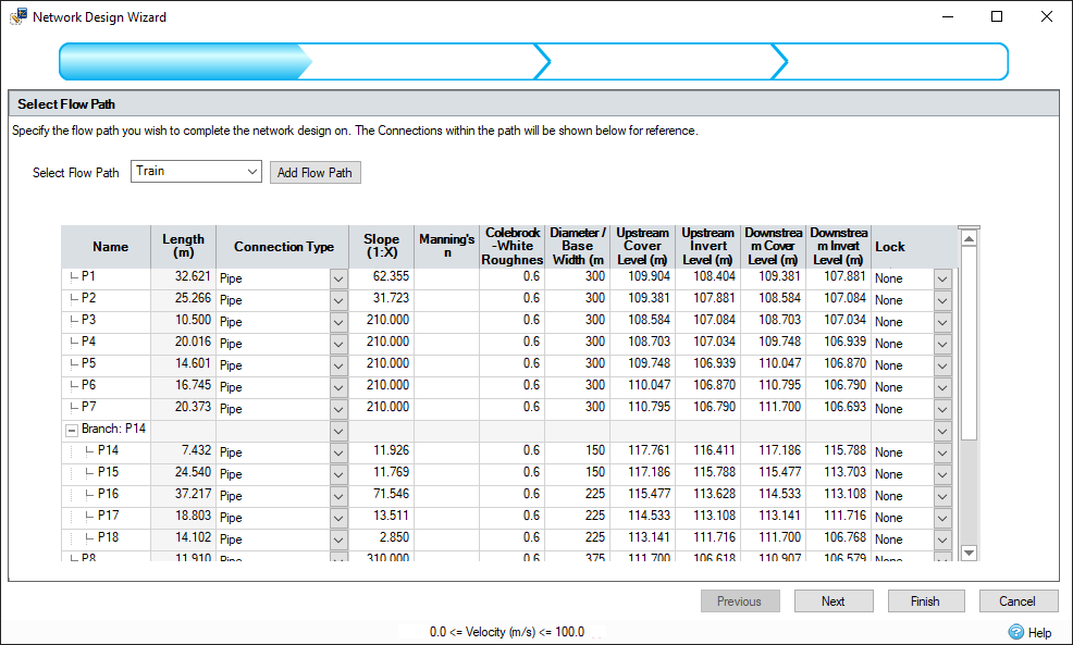

Select Flow Path
Here you can specify which flow path you wish to size using the drop-down box. The connections within that path will be shown in a table. Final edits can be made here before the sizing continues.
Additionally, if the current flow paths are not suitable (or none are available), a new Flow Path can be created using the Add Flow Path button. This will allow you to create a path as usual; when complete, the sizing wizard will re-open with the new path.
Some validation will be performed when the Next button is clicked, to ensure the connections can be sized. If any errors are found during this step, suitable warnings will be presented within the grid, and can be corrected before continuing. Any changes made at this step will be committed only if the wizard is completed successfully.
Inflows leading into the selected path (including Branch lines) will also have some validation performed on them. Warnings generated from this will be present in the Name column of the table. The wizard must be closed in order to resolve any errors on Inflows.

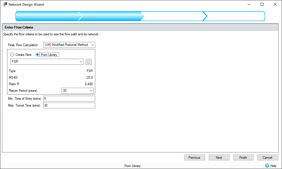

Enter Flow Criteria
The Flow Criteria is the set of parameters describing the flow into and along the network.
Note: This page is only available for storm phases.
Peak Flow Calculation
Select the calculation method to be used when sizing the pipes/channels. Choose from:
Rational Method : Flow = Rainfall Intensity x Total Area + Total Base Flow
(UK) Modified Rational Method: Flow = Rainfall Intensity x Total Area * Cr(1.3) + Total Base Flow
Methode de Caquot – Flow is calculated via the Methode de Caquot equations which are considerably more involved that the Rational Method or (UK) Modified Rational Method equations. The method's inputs are the Caquot (Base and Advanced) parameters, selected Desbordes rainfall parameters and the Runoff Path Length and Catchment Slope of the Inflows upstream of the pipes belonging to the auto-sized Flow Path. Further information can be found on the  Methode de Caquot page.
Rainfall Source
When Rational Method or (UK) Modified Rational Method is selected from the Peak Flow Calculation list box, the Rainfall Source list box lists the currently configured IDF curves and FEH, FSR, ARR and Desbordes rainfalls in the Rainfall Manager. When autosizing pipes/channels, the rainfall intensity will be retrieved from the selected rainfall source based upon the Travel Time for the pipe/channel.
When Methode de Caquot is selected from the Peak Flow Calculation list box, the Rainfall Source list box lists only the Desbordes rainfalls configured in the Rainfall Manager.
In either case, the parameters of the selected Rainfall Source are displayed below the Rainfall Source list box. In addition, if the Methode de Caquot is selected from the Peak Flow Calculation list box, the Caquot Base Parameters and Use Shape Correction tick box are displayed below the parameters of the selected Rainfall Source. To the right of the Base Parameters is a calculation button. Clicking on this displays a separate form which allows the user to modify the Advanced Caquot parameters, which in turn recalculates the Base Caquot parameters shown on the Network Design Criteria form.
Minimum Time of Entry
This is the minimum time that should be applied to the Time of Entry. It is the time it takes the rainfall falling on the catchment to reach the head of the line, which can be considered the Time of Concentration for the inflow area. This is added to the time of travel in the connection to produce an overall Time of Travel throughout the network as shown in the Network Design Report. This is required at the head of each branch line.
Maximum Travel Time
This allows the maximum travel time down the system to be capped at the given value. This prevents the Intensity being used to size the pipe/channel reducing to low.

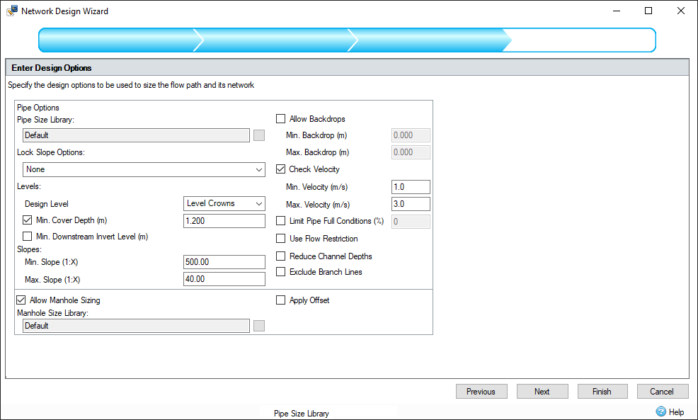

Enter Network Design Criteria
The Network Design Criteria is the set of parameters required to size pipes/channels along a given network.
Pipes Size Library
The Pipe Size Library is a sequential list of pipe diameters. New pipe libraries can be defined by clicking on the button next to the box.
Lock Slope Options:
None
Selecting this will not apply any locks to the Network Design beyond the Minimum and Maximum slope set further down.
Slope
This option will stop the Network Design from adjusting the slopes of the connections in the current path. This is useful for a mostly complete site, which only requires the diameters and levels of the pipes to be changed.
Slopes and Invert/Soffit Levels
These options will disallow the Slopes and the Invert or Soffit levels to be changed by the Network Design. Only the pipe sizes can be adjusted; the unlocked level will be adjusted as needed, i.e. for Slopes and Invert Levels, the soffits will adjust to accommodate any pipe size adjustments.
Levels:
Design Level
Choose Level Soffits or Level Inverts from the list box to design the system with Level Soffits or Level Inverts respectively.
Note: Level Soffits only applies to Pipes as Channel soffits are already aligned to the cover level.
Minimum Cover Depth
The desired depth from the pipe soffit/channel top to the cover level. When ground levels have already been input, the program will warn the user when the desired cover to ground level has not been achieved.
When the option is turned on, the auto size calculation will attempt to redesign the system and achieve the above cover where it is feasible. If individual connections have a Minimum Cover Depth value set, then these individual values take precedence for those connections. If this option is not turned on then the individual Minimum Cover Depth values per connection are ignored.
Note: Level Soffits only applies to Pipes as Channel Soffits are already aligned to the cover level.
Minimum Invert Level
When the option is turned on, the auto size calculation will attempt to redesign the system to allow the connection to align itself to the specified Minimum Downstream Invert Level. The Minimum Downstream Invert Level value can be set only on a connection, the highest value is taken if there are colliding values.  This redesigning process would take precedence over all of the other rules. Cover Depth and Slope might be broken in order to align the Invert Level.
Slopes:
Minimum Slope
The minimum slope for a pipe/channel. This is desirable when the ground is flat or sloping away from the pipes, and minimum slopes are required to reduce excavation. This value is always used if limits are not set in the Pipe Size Library .
Maximum Slope
The desired maximum slope for a pipe/channel. This can be desirable to ensure that the pipes in place cannot become insensibly steep. This value is used if limits are not set in the Pipe Size Library. Pipe slopes may be made less steep to meet max slope if they are made too steep in the sizing.

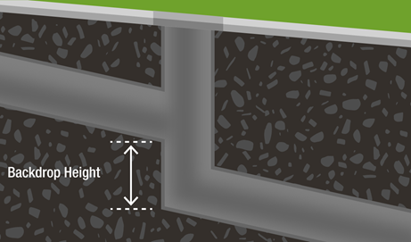

Allow Backdrops:
When the option is turned on, the auto size calculation will allow backdrops to be introduced where the backdrop is within the Min/Max range. A backdrop may be introduced when downstream connections are lower than an incoming pipe. A backdrop may also be introduced where a downstream cover level causes a steeper slope than is needed; in this scenario, a backdrop is introduced only if the pipe size doesn't need to be increased.
A backdrop is measured from the desired connection level of the two connections, which will be governed by the Design Level and then the connections type, i.e. Level Soffits, will mean soffit levels are considered unless one of the sections is a Channel, at which point the software would assume Level Inverts.
Minimum Backdrop
The minimum backdrop between two incoming pipes/channels. The program will remove any backdrop below this value when the Allow Backdrops option is turned on.
Maximum Backdrop
The desired maximum backdrop between two incoming pipes/channels. The program will reduce any backdrop greater than this value to the maximum when the Allow Backdrops option is turned on.
Check Velocity:
When the option is turned on, the auto size calculation will attempt to redesign the system and achieve a velocity in the given range where it is feasible. In a Foul phase, an additional combo box is available to pick the velocity method – Full Bore, 1/3 Proportional Velocity and (UK) 1/3 Proportional Velocity (Only available in UK region).
Minimum Velocity
The minimum velocity for a pipe/channel. The program will then choose a size and slope with sufficient capacity to give the required velocity.
Maximum Velocity
The desired maximum velocity for a pipe/channel. The program will attempt to select a size and slope with sufficient capacity that does not exceed the suggested velocity but this may be broken to meet other criteria, such as cover depths. In this case a warning is given at the end of the wizard.
Use Flow Restriction
When this box is ticked, the Network Design will use any non-zero design flows as the base flow for the corresponding connection.
Reduce Channel Depths
Checking this option allows the Network Design to reduce channel depth and height by considering incoming connections to the channel.
Limit Pipe Full Conditions
The amount of the pipe that is filled to be considered too "full".
Selecting this option limits the base flow of any connection with a flow restriction, to that flow restriction.
Exclude Branch Lines
Selecting this option allows the Network Design to perform the pipe sizing only on the mainline.
Allow Manhole Sizing:
When this option is turned on, the Network Design will also attempt to size the junctions and the below fields will be enabled to configure this.
Manhole Size Library
The Manhole Size Library is a list of multiple categories relating to the size of the manholes in relation to the connection and depth. This is also used to determine the ladder protrusion, landing and benching width which are needed for offsetting.
Apply Offset
Ticking this option determines that offsets are required on any junction that meets the requirements. See Manhole Auto Size Calculations for more information on offsets and their requirements.

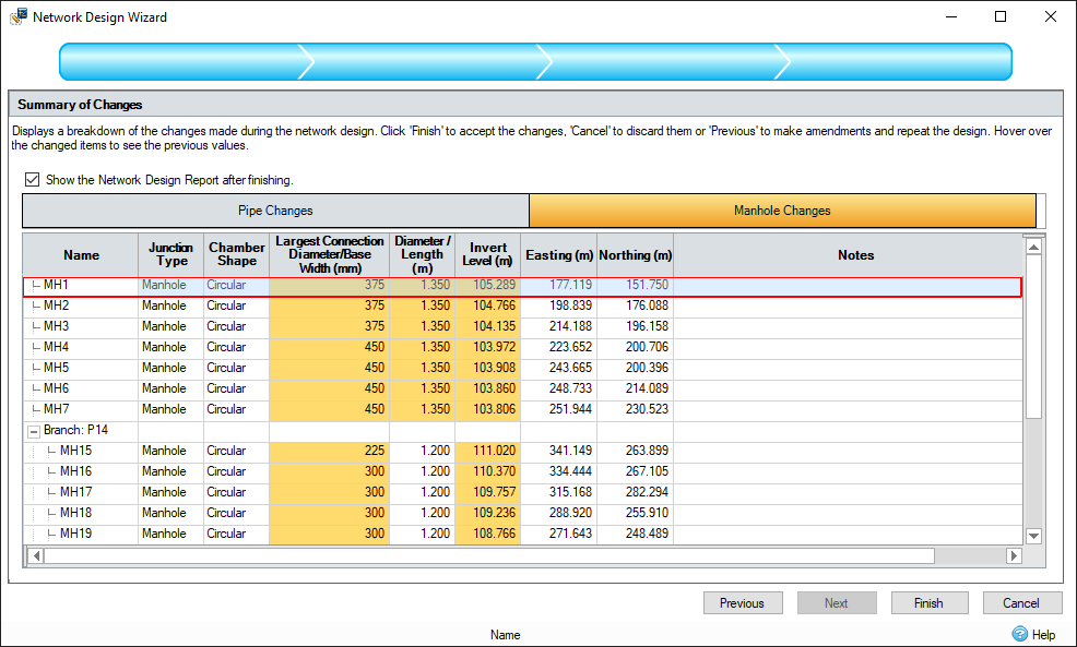

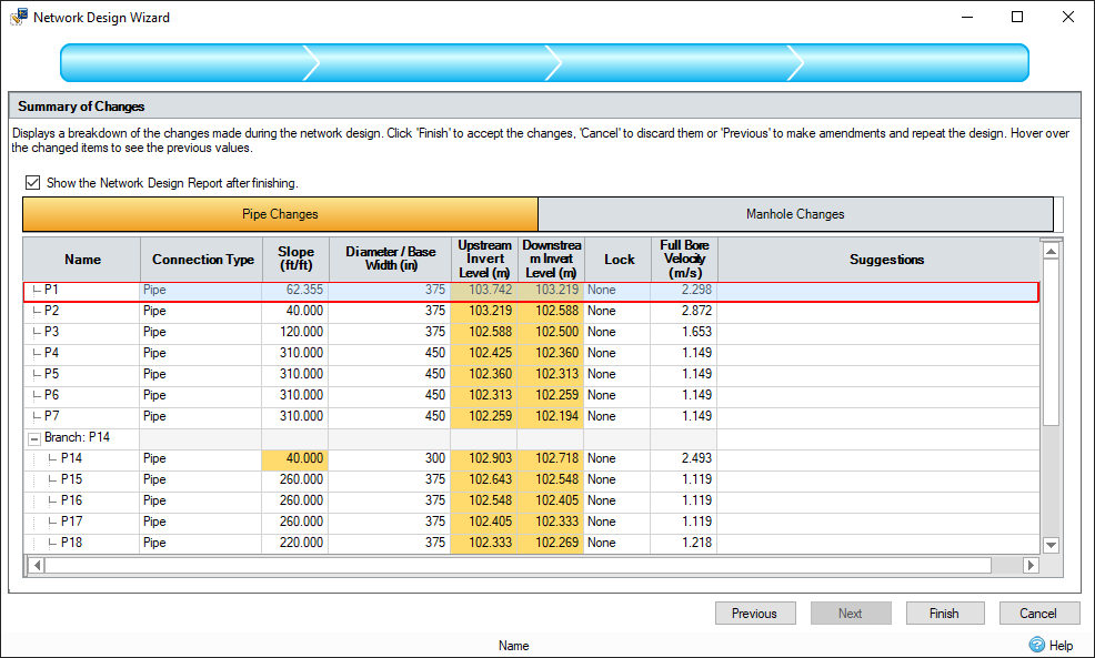

Summary of Changes
Once the Network Design has been completed, a summary screen will be displayed showing all the changes made.
Note: In Foul phases, if 1/3 proportional velocity or (UK) 1/3 proportional velocity is selected in the pipe sizing criteria, the Full Bore Velocity column will be replaced with 1/3 Proportional Velocity column
Two Tabs will be visible, Pipe Changes displays the changes made to the Pipes and Manhole Changes displays the changes made to the manholes.
All changed values will be highlighted in the current highlight colour to easily distinguish them. Hovering over the highlighted cells will display the previous value in a tool tip.
From here, the changes can either be discarded by clicking on Cancel, Accepted by clicking Finish or The sizing can be undone by clicking Previous, allowing the user to change the flow path or Network Design Criteria. After the user clicks Finish, the Network Design Report window may be opened, depending on the state of the relevant tick box.
