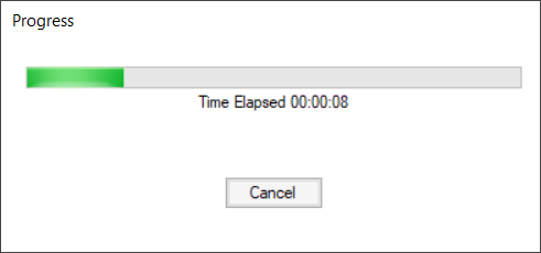

When the Interactive Deluge option is selected, a call will be made out to the web service, uploading surface information and subsequently receiving back data in the form of a bitmap image. This image shows a perceptually uniform sequential colourmap in the Viridis colour scheme, based on depths ranging from 0 m to 1.5 m. This image is then overlaid onto the existing site plan for comprehensive analysis. During this process, an analysis progress form will be displayed to keep you informed of the computational progress.
