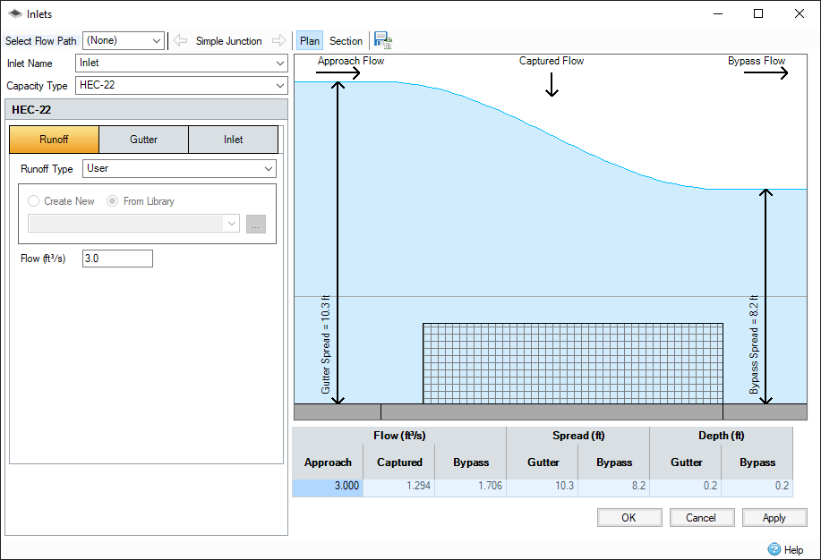

The Inlets Form displays capacity details for Inlets.
HEC-22 Inlets can be sized and display a results table and preview images.
Toolbar – Contains tools for the selection of a specific node within a flow path, and buttons for switching the view of the HEC-22 preview image.
Select flow path – A flow path can be selected from this drop-down list to manage access to nodes. Selecting (None) will allow access to all nodes.
<-- X -- > – The left and right arrow buttons can be used to move along the flow path from node to node. The currently selected node will determine the inlets available, and be shown between the arrows.
Section – Available only to HEC-22 Inlets. Sets the preview image to the cross-section view.
Plan – Available only to HEC-22 Inlets. Sets the preview image to the plan view.
Inlet Name – Where a node has multiple inlets, this drop-down list can be used to select a different inlet.

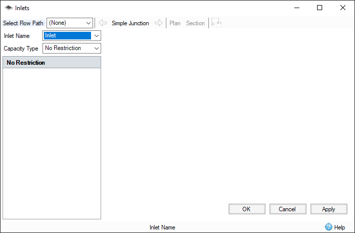

Capacity Type – The capacity type of an inlet can be modified from the inlets form. For more information, see the Capacity Type section of the Inlets help page.
Certain components of the form are available only to HEC-22 Inlets.
Preview Image – The image in the upper right of the form. This provides diagrams of a top-down plan view, cross section view of the inlet and water passing over the inlet. The image is not displayed for HEC-22 inlets that are In Sag.
Table of key values – Contains key values of flow, spread and depth.
