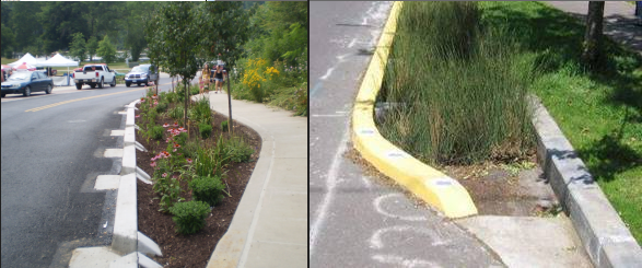

Inlets allow flow from Inflows or from an incoming Connections to be captured and routed into Junctions, Manholes, Stormwater Controls (SWC) or bypassed to another location.,
Inlets are created as part of a Junctions, Manhole or Stormwater Control to stipulate how much of the approaching flow will enter the structure.
Each system can have one or more inlets with each inlet able to support multiple incoming inflows and connections.
