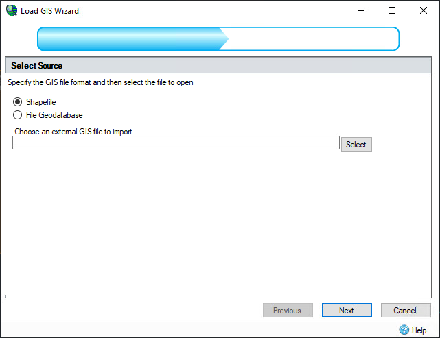

Currently supported formats are:
Select Source
This step allows the location of the file to be loaded by pressing the select button after selecting the file format.

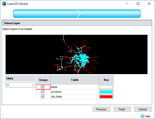

Select Layer
This step allows layers of the CAD file to be turned off before loading, as well as setting the units of the file, providing a preview image of the file, and additional options when loading surface data.
Units
Select the units that the GIS data being loaded is in so that it can be converted for use with the current Unit Selection within the software.
Tables Spreadsheet
The preview pane displays data from the currently selected tables. Tick the box to toggle the selection of the table's data. At least one table must be selected, so if the data source contains only one table, the tick box will be disabled.
Table
Displays the name of the table.
Key
Click the button to change the colour of the table's data in the preview pane.
