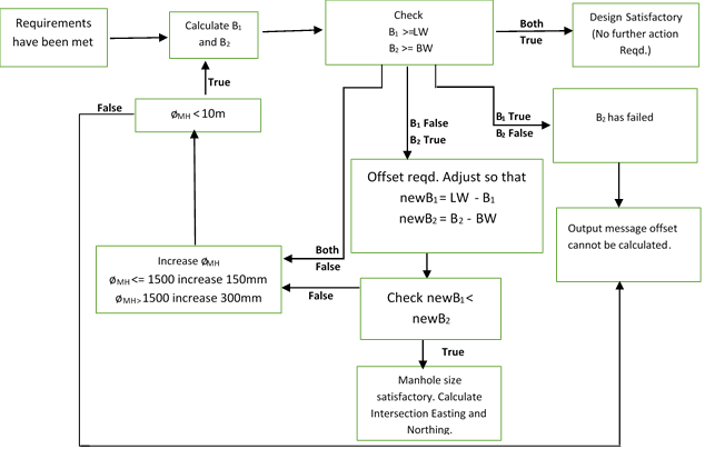

  5. Offset Calculated – If the above requirements are met then the offset is calculated and applied if possible. The offset is calculated using a routine seen in the flow chart below:
Key
ø MH Diameter of Manhole (mm)
ø OUT Maximum diameter/width of connection entering or exiting manhole (mm)
Ɵ      Angle between incoming and outgoing connections
L       Ladder Protrusion (mm)
LW   Landing Width (from Manhole Size Library) (mm)
BW   Benching Width (from Manhole Size Library) (mm)
B1     Base Landing Width (mm) = ø MH/2 – L –  ø OUT/2
B­ 2    Base Benching Width (mm) =  ø MH/2 –  ø OUT/2Cos(Ɵ/2)
As seen by the above routine, the offset either fails and outputs a message, does not require an offset as there is already enough space or calculates a new Intersection Easting and Northing as the offset has been successful.
