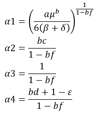

The coefficients  are calculated using the advanced parameters according to the following equations:

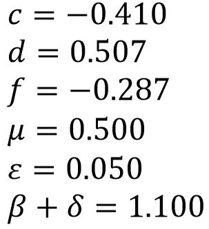

where the parameters a and b refer to the parameters used in the Desbordes rainfall, and the advanced parameters c, d, f, μ, ε, β, δ derive from the assumptions on the estimation of the time of concentration and storage in the catchment, and the areal reduction of the rainfall. The default values recommended by the guidance documents referenced above are displayed below. These can be used in most situations, but can also be edited by the user.

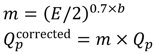

The formula above assumes that the catchment has a shape factor E approximately equal to 2.
where L is the length of the longest hydraulic path in the catchment and A is the area in m². If the shape factor E is very different from 2, the peak flow Qp needs to be corrected by the following shape correction factor:

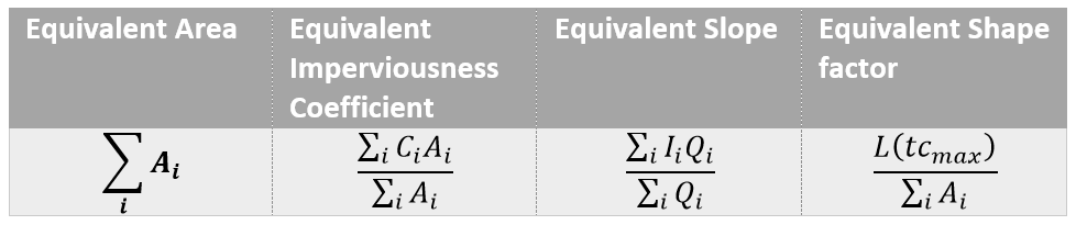

The main distinction is between catchments grouped in a serial way or in a parallel way. Because in InfoDrainage catchments are connected to a connection or to a Stormwater Control (and not to another catchment), only the parallel grouping makes sense in this context. The table below gives the relations used to calculate the equivalent properties of several grouped catchments.
where L(tcmax) is the runoff path length of the catchment with the longest Time of Concentration.

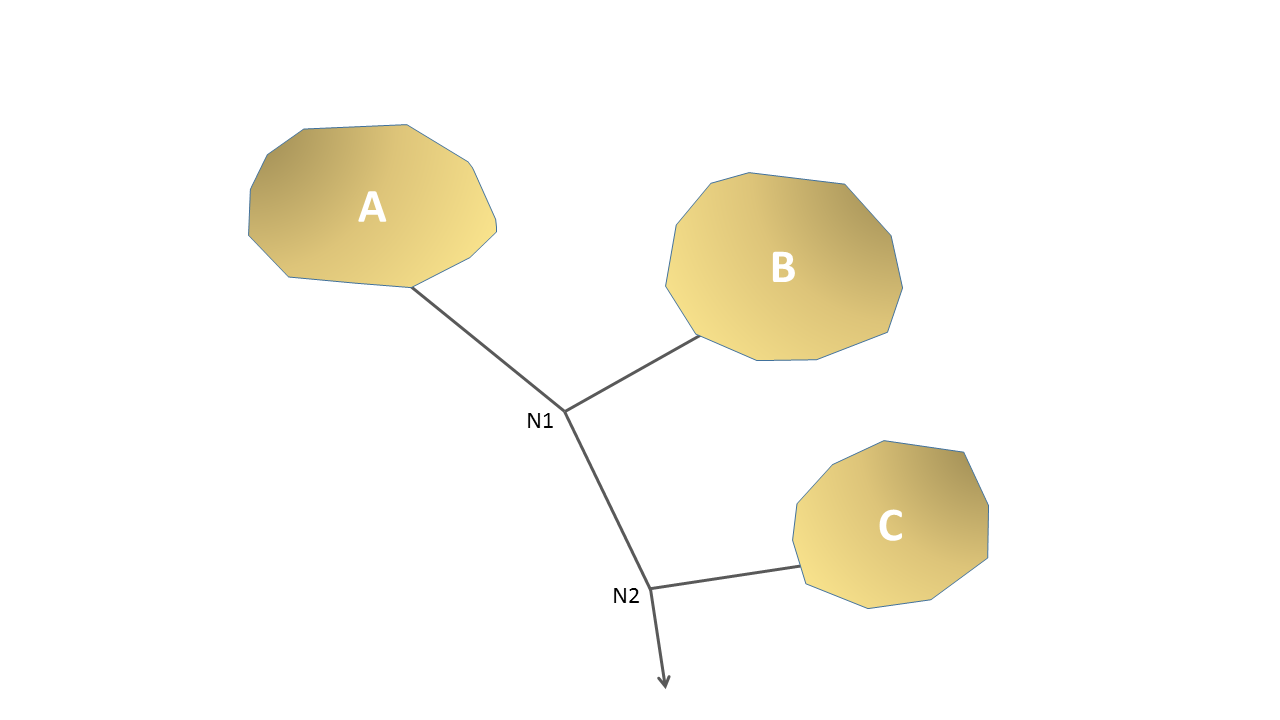

For the estimation of the peak flows throughout the drainage system, InfoDrainage follows the network from all catchments and identifies the junctions. At each junction, InfoDrainage calculates the equivalent catchments properties from the 2 or more connecting branches. Then these equivalent catchments properties are kept in memory, to be used further downstream if a grouped catchment needs to be grouped with another catchment.
For example, let us consider the simplified network below with the 3 catchments A, B and C. At network location N1, the peak flow is estimated by calculating the properties (via parallel grouping //) of AB = A // B. At network location N2, the peak flow is estimated by calculating the properties of ABC = (AB) // C.
