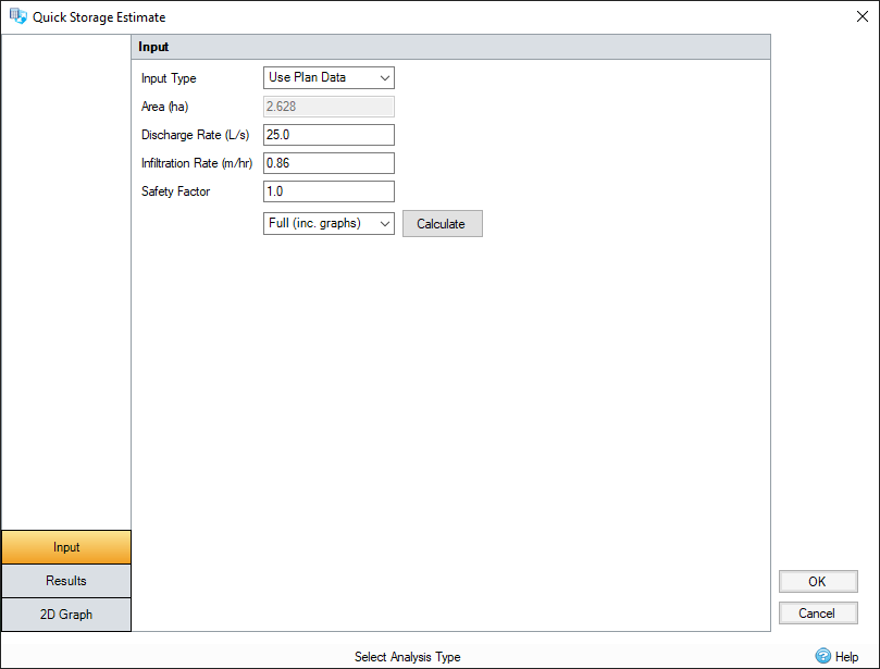

Input
This form allows you to input all the required fields for making the calculation.
Input Type
Area  – This is the total impermeable (roof and paved) area in hectares.
Volumetric Runoff Coefficient (User Input Data only) – The proportion of rainfall falling on the catchment that enters the site as surface runoff.
Discharge Rate – The maximum discharge required from the Site.
Infiltration Rate – If set to 0, all outflow will be through traditional controls and will be limited by the Discharge Rate. If set to a non-zero value, this defines the infiltration rate from both sides and base of the structure. Any infiltration flow is in addition to the maximum allowable discharge from the control. If the Infiltration rate is set, the program will generate an Infiltration feasibility overlay for the results graphs.
Safety Factor – Reduces the infiltration rate during the analysis to account for silting up or poor maintenance. This is required for the UK.
Note: This option may not be available for your region. For more information, refer to the Regionalisation topic.
Increase Rainfall  (User Input Data only) – This will scale all rainfall by the amount specified.  This can be used to take climate change, or other factors, into account. Input hydrograph flows are not scaled.
Rainfall Method (Use Plan Data only) – A set of rainfall options are available to choose from:
Quick/Full (inc. graphs) – Both these options produce the range of results with and without infiltration. However, the Full option also produces the 2D graphs.
When all variables have been set as required, click Calculate to generate the results.

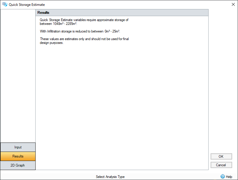

Results
The programme shows the upper and lower bounds of storage required for the variables given.
If the infiltration coefficient is set to a non-zero value, then a range of storage required will also be presented for an infiltration system.

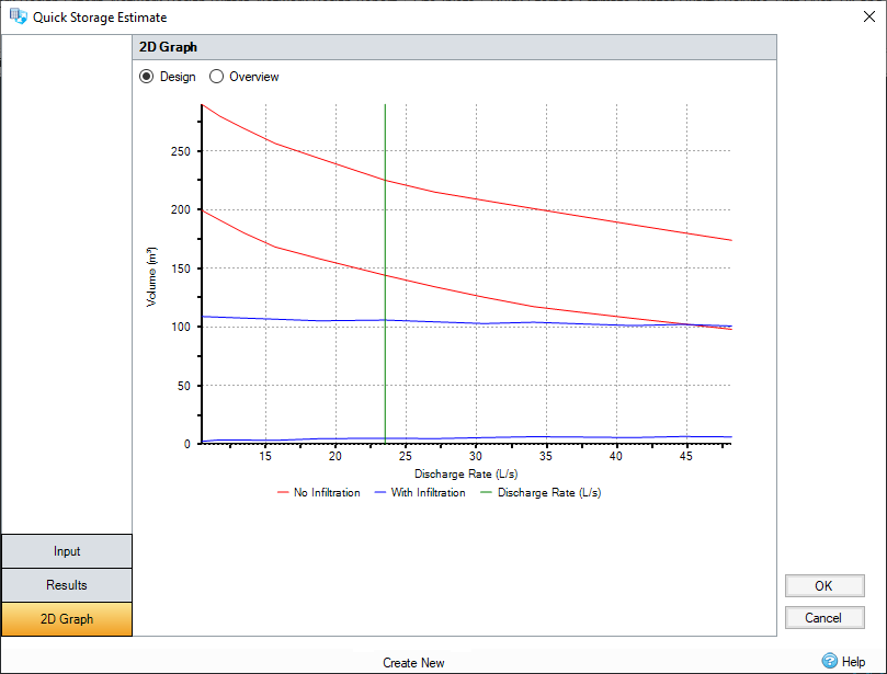

2D Graphs
Another output of the Quick Storage Calculator is a 2D graph with Discharge Rate vs Volume of the computed result.
Design Graph
The Design graph shows the effects on storage requirements of varying the maximum discharge rate. The minimum and maximum storage is shown in purple. The green vertical line shows the specified maximum allowable discharge rate. If the infiltration coefficient is set to a non-zero value, then maximum and minimum storage requirements of an infiltration system are overlaid in blue.
Overview Graph
The Overview graph shows the effects on storage requirements of varying the maximum discharge rate. A much larger range of discharge values are shown than the Design graph. The minimum and maximum storage is shown in purple. The green vertical line shows the specified maximum allowable discharge rate. If the infiltration coefficient was set to a non-zero value, then maximum and minimum storage requirements of an infiltration system are overlaid in blue
