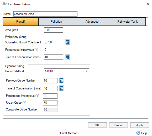

The Santa Barbara Urban Hydrograph method is described in this document from the Washington State Department of Ecology (section 2.3.3), with the input attributes described below.
Note: This method may not be available for your region. For more information, refer to the Regionalisation topic.
Pervious Curve Number – The runoff curve number for the pervious fraction of the Catchment, as described in National Engineering Handbook – Section 4 (NEH-4) Chapter 9. Typical values vary from 20 for areas with high infiltration and interception capacities to 98 for impervious areas. It is a dimensionless number depending on hydrologic soil group, cover type, treatment, hydrological condition and antecedent moisture conditions. This number has a valid range from 0 to 100, with typical values from 60 to 90 and 98 for impervious surfaces.
When the Use Land Uses/Soil Types layers box is ticked, the Pervious Curve Number is calculated from weighted averages of Land Uses and Soil Types.
Pervious and Impervious Curve Numbers
The Pervious CN characterises the fraction of the Catchment that is not impervious (area derived from the Percentage Impervious value). The impervious fraction of the Catchment is assigned a default CN of 98.
The Curve Number Calculator can be used when the Use Land Uses/Soil Types layers box is unticked. The calculator can be accessed using the button to the right of the field. This provides a quick and easy way to select the appropriate curve number.

Percent Impervious – Pervious portion of the Inflows area. When the Use Land Uses/Soil Types layers box is ticked, the Percentage Impervious is calculated from weighted averages of Land Uses.
Composite Curve Number – The weighted CN used by the simulation. It is calculated as follows:
CN = (PIMP / 100 * 98) + ((1 – (PIMP / 100)) * PACN)
where:
PIMP = Percent Impervious
PACN = Pervious Area Curve Number
Urban Creep – This scales the impermeable area by the amount specified. This can be used to take the increase of urban areas, or other factors, into account. This value is only enabled (and used) when the analysis creep of the Analysis Criteria is set to "Use Catchment Areas".
