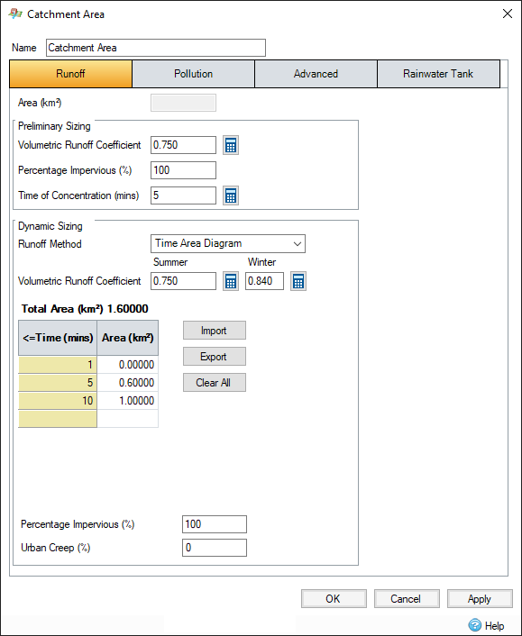

Time/Area Diagram
Sub-catchments may be entered in the form of a Time/Area spreadsheet. The hydrograph is calculated by combining the rainfall profile with the time area input. The Time/Area diagram accounts for the effect the time of flow into the stormwater control has on the inflow hydrograph.
Note: This method may not be available for your region. For more information, refer to the Regionalisation topic.
Spreadsheet – Enter the area that enters the storage structure for each timestep.
Percent Impervious – Pervious portion of the Inflows area. When the Use Land Uses/Soil Types layers box is ticked, the Percentage Impervious is calculated from weighted averages of Land Uses.
Urban Creep – This scales the impermeable area by the amount specified. This can be used to take the increase of urban areas, or other factors, into account. This value is only enabled (and used) when the analysis creep of the Analysis Criteria is set to "Use Catchment Areas".
