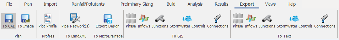

The current model displayed on the Plan can be exported to a CAD file (.dxf or .dwg) via the To CAD button on the Export ribbon.
Clicking the Save CAD button will prompt the user to choose a location and file name for the exported CAD file. File types available are:
