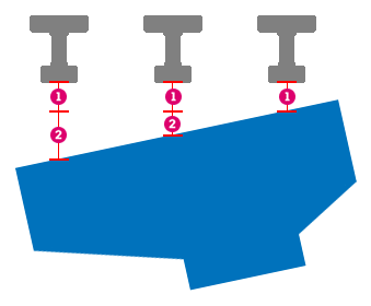

Vertical Placement
Each bearing must set to the total height of the bearing. This value creates enough space for the bearing between its girders and supports. If the top surface of a support, and the aggregate bottom surface of the girders above are not parallel, then it is not possible to make all the gaps between them exactly. One bearing below a girder is specified with the Overall assembly height parameter. Remaining girders will adjust with the Extra height parameter.
Bearing height dimensions
one BearingAssemblyHeight
two ExtraHeight
