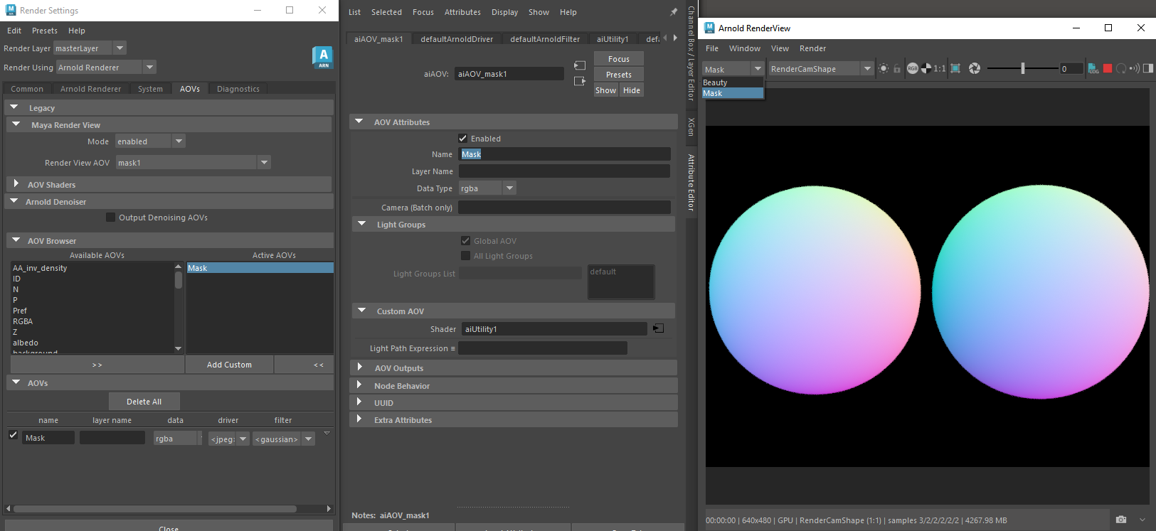

The Attribute Editor
See Render Settings in the Arnold User Guide
Each AOV has a node associated with it. You can use the attribute editor to examine these nodes in more detail.

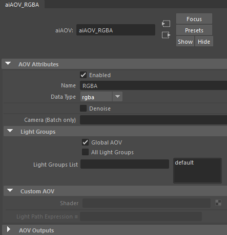

AOV Attributes
Enabled
The AOV will only be written to disk if this attribute is checked (even if the AOV is in the active list).
Name
The name of the AOV - this will form part of the name on disk. Initially, this just takes the name from the standard names displayed in the AOV browser, but you can alter the name as needed (you should probably choose a name that enables you to tell what sort of AOV it is). Note that you can add a prefix to this name using the Prefix attribute.
Data Type
The type of data to be written in the AOV - rgba, float, vector, etc. Arnold will normally specify a default type for each AOV, so you don't have to explicitly set this. Note that the attributes under the 'Node Behavior' tab are standard Maya attributes common to all the nodes in the scene.
Denoise
For use with the Optix denoiser (System tab). This filter can be applied to any AOV just like a normal filter.
Camera (Batch only)
This can be used to set a specific camera to an AOV. This only works with batch renders.

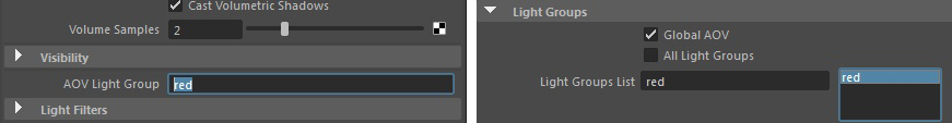

Light Groups
The contribution of multiple light sources can be written out to separate AOVs when they belong to the same light group. A light group can have multiple lights, but one light can belong to only one group. The group is defined by the AOV light group parameter of the light. The available light groups are listed on the right in the dialog, you can select which light groups are rendered by the selected AOVs. Each selected light group represents a new AOV with the name of the light group as a postfix (e.g. diffuse_direct_group01, specular_direct_group02, sss_default ). The group called default contains those lights which do not belong to any group (the AOV light group parameter is empty).
AOV Light Group named 'red' in light (left). 'Red' Light Group selected in AOV (right).

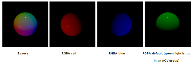

Light Group Example
In this example, a sphere is lit by three lights, a blue, a red and a green light. The blue and red lights have different AOV light groups defined while the green light does not belong to any group.
" default " is the beauty AOV that is lit by lights, not in any AOV light group. " RGBA_default " + " RGBA_red " + " RGBA_blue " give the total RGBA beauty pass.
Beauty, RGBA_red, RGBA_blue, RGBA_default (green light is not in an AOV group)

Global AOV
Outputs a Beauty AOV that contains those lights which do not belong to any group.
All Light Groups
Outputs one AOV per light group in the scene. When the All Light Groups checkbox is enabled then each of the light groups will be rendered. Otherwise only the selected ones will be rendered. With Batch rendering, it will output everything in the same EXR file with different channels, one for each light group.

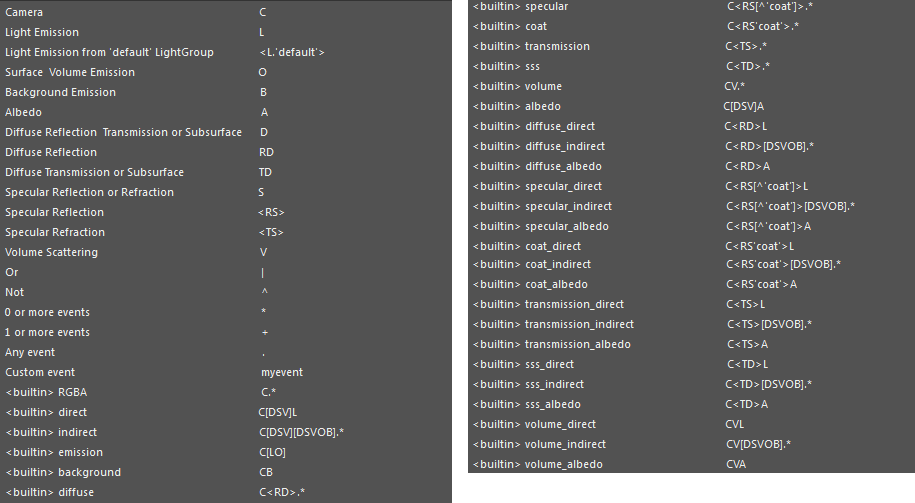

Light Path Expressions
You can define custom Light Path Expressions to write lighting components into separate AOVs using the following method:
Diffuse LPE set in Custom AOV in attribute editor
To choose the type of LPE click on the icon to the right of 'Light Path Expression'. You will see a list of available AOVs (with their associated LPE).
Note:
Other Light Path Expressions can be found here.

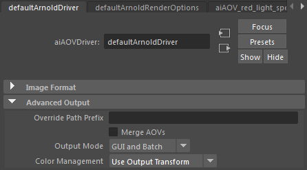

Arnold Driver Advanced Output
Override Path Prefix
Overrides the Maya File name prefix for the AOV.
Output Mode
Choose to view the AOV in the Render View (GUI) in Batch rendering or both.
Color Management
This allows you to set a specific color space to output rendered images. By default, 8-bit images apply the View Transform through this attribute (sRGB by default), and 16/32 bit images apply the Output Transform (which is 'Raw' by default).
