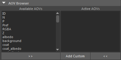

AOV Browser
The AOV Browser allows you to select the AOVs you want to be active for your render. You can also choose to add a custom AOV.
Either double-click or select and use the arrow buttons to move AOVs from 'Available' to 'Active'.

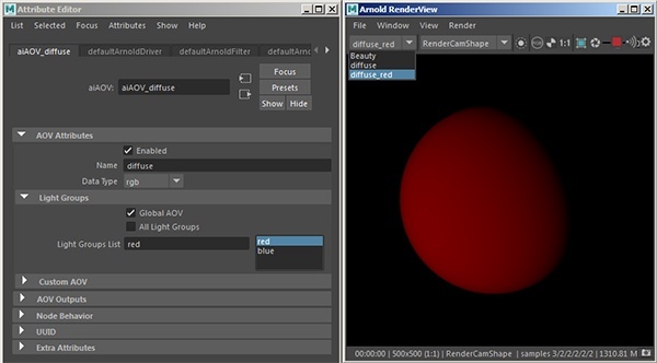

Per-Light AOVs
Each light object has an ' AOV Light Group ' attribute which can be used to write out the light contribution to a separate AOV with a corresponding name. To create a per-light AOV, you must do the following:
  1. Enter a name for the per-light AOV in the 'AOV Light Group' of the light. In this case, we have a red and a blue light in the scene and so the light groups have been named red and blue.
AOV Light Group in Arnold attributes of light
2. Create an AOV and select it to show it in the attribute editor (in this case we have used a diffuse AOV).
3. Render the scene. The AOVs should now be visible in the RenderView by selecting them in the Light Groups List.
