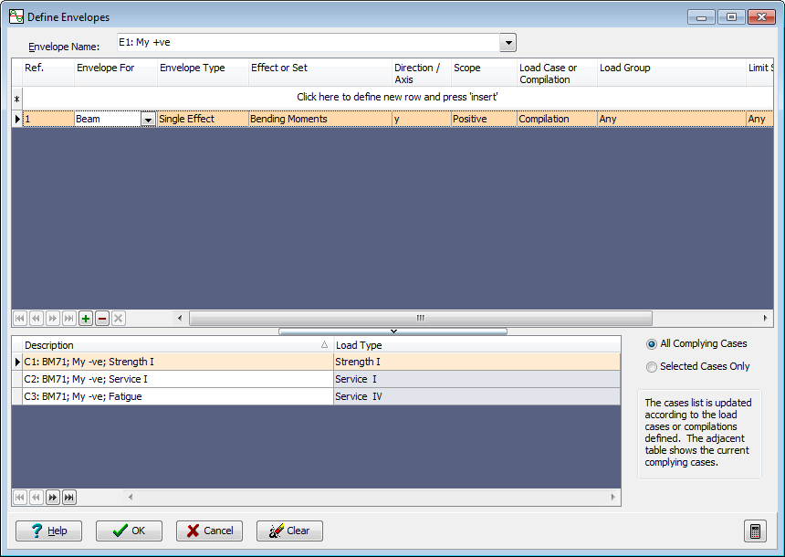

Define Envelopes
Go to Field Help
Description
The envelope of a given load effect at a given point on a given structural element is the extreme maximum or minimum bound of all the results for that load effect at that point on that element for a given selection of load cases and load compilations.
This form is divided into two tables. Each row in the upper table defines one envelope. For each envelope there is a corresponding list, displayed in the lower table, of the load cases or compilations whose results for a given effect are to be compared to find the most extreme results (the result envelope for that effect).
The upper table (fundamentally) defines the effect whose results are enveloped. Subsidiary columns in the upper table define conditions that allow the user to filter the load cases or compilations listed in the lower table such that (for instance) only load compilations for a particular type of highway loading are considered when creating a particular envelope.

Procedure
This form is accessed through Calculate | Envelopes.
For details of the table features, and navigation, see the help topic Table Features and Navigation
To define an envelope :
  1. Click on the panel of the upper table labeled Click here to define new row and press 'insert' (alternatively use the Insert Record button at the bottom of the upper table). The area becomes a template row of the upper table with a default 'Ref'.
  2. Define each of the cells in the template row (as described in the field help of this form).
  3. Click on the Insert Record button of the upper table. The row is added to the upper table to become the currently active row. The lower table is populated automatically with all load cases or combinations complying with the conditions defined in the new row of the upper table.
  4. The new envelope (row) has automatically been given a default name that is displayed in the Envelope Name field. It can be edited to any alternative name. But 'E' and the envelope reference number are always prefixed to the final name.
The lower table will list all the load cases or compilations filtered according to the defined envelope details. Note that this is a dynamic list, and will be updated if further load cases are defined, whether or not the envelope details are viewed again from this form.
To define an envelope manually:
  1. Having carried out stage 1 to 4 above, Click on the Selected Cases Only radio button.
  2. Click on the Clear Cases button. Acknowledge the warning. The lower table is emptied.
  3. Click with the mouse on the panel of the lower table labeled Click here to define new row and press 'insert' (alternatively use the Insert Record button at the bottom of the lower table). The area becomes a template row of the lower table.
  4. Click in the leftmost column of the template row. The drop-down that appears lists all the load cases or compilations complying with the conditions defined in the new row of the upper table.
  5. Click on one of the required load cases or compilations for the envelope. It is added to the lower table.
  6. Continue until the table defines the full required set of load cases or compilations.
Manual definition of an envelope is unlikely to be able to discriminate which load cases or compilations are critical. So manually defined envelopes are likely to include redundant load cases or compilations. If the 'Envelope Type' is 'Single Effect' then Find Cases may be helpful to determine which load cases or compilations are critical for any of the structure elements complying with the row in the upper table and include only these relevant cases in the lower table.
To define an envelope using Find Cases: AnalyzeAnalyze
  1. Define all the load cases and compilations that may need to be considered.
  2. Analyze the structure using Calculate | Analyze... of the ribbon.
  3. Progress through steps 1 to 5 (inclusive) above. Note: 'Envelope Type' must be 'Single Effect' or Find Cases will be inactive.
  4. Click on the Find Cases button. Acknowledge the warning. The lower table is automatically populated. Each newly added row is a load case or compilation that creates a critical result for the defined 'single effect' at any point in the structure.
The lower table will contain a static list of the load cases or compilations that have been selected.
Envelope definitions created automatically during influence surface load optimisation are an important special case. This form displays the load cases and compilations comprising each automatically created envelope. Automatically created envelopes may be edited in this form, but that is not advisable as the edited envelope definitions may not include all critical cases.
Envelope results may be viewed, selected and manipulated through the Tabular Results form.
Click in any row in the upper table to make the envelope defined in that row currently active, and displayed in the lower table.
Click on a table header to sort the table according to the selected column (or to invert the sort order if already sorted on that column).
Splitter Bar
The height of the upper/lower table can be adjusted by clicking on the splitter bar and keeping the mouse button pressed down as the splitter bar is dragged up or down until the button is released when the table is at the desired height.
When the lower table is visible the icon on the Splitter Bar points downwards (as shown above). Clicking on the splitter bar will hide the lower table, leaving the icon on the splitter bar pointing upwards.
When the lower table is hidden the icon on the Splitter Bar points upwards. Clicking on the splitter bar will restore the lower table to its previous height.

Field Help
Envelope Name
This field displays the name of the envelope defined in the current active row of the upper table.
When a new envelope has been posted in the upper table it becomes the current active row and a new short default name, generated automatically, is displayed in this field.
Clicking the left mouse button with the cursor over this field causes the prefix ('E' and reference number) to be removed and the rest of the name to become editable. Normal text entry can be used to create any chosen name. On leaving this field (so it looses focus) the newly defined name is displayed but prefixed with 'E' and the envelope reference number.
Clicking the left mouse button with the cursor over the right-hand (drop-down) icon of this field causes a drop-down list of the names of all currently defined envelopes to be displayed. Clicking the left mouse button with the cursor over an item in the list makes that envelope the currently active row in the upper table.
Ref
Envelope reference number. Display only not editable.
Envelope For
Click and select the results type that is to be enveloped. Menu items correspond to the results types for tabular results. (These may be thought of as groups of structural elements.)
Envelope Type
Click and select the envelope type from the following options:
Effect Description
Single Effect Envelopes the results of a single defined effect only (e.g. Bending Moments, y, -ve).
