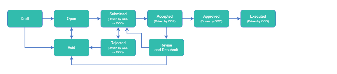

The following is a typical flow of statuses for PCOs:
Potential change orders have the following budget statuses:
- Draft: During the creation state of a PCO.
- Open: When a PCO is set to Open, it formally enters into the system. All of its cost items are also set to open. You can now generate an RFQ, COR, OCO, or SCO.
- Submitted: Submitting the change order for approval activates this status. Cost items can no longer be added or removed.
- Accepted: The owner accepted the budget change through an RCO.
- Revise and Resubmit: One from the party hasn't accepted the change order and requested revision. Check what is required and submit revised change order.
- Approved: The owner approved the budget change through an OCO.
- Executed: All parties have signed the budget change order.
- Rejected: Not accepted by the owner. You can revise and resubmit.
- Void: Only when a PCO and its cost items are not associated with any COR/OCO/RFQ/SCO, and no contract is generated from its cost items, the PCO can be void.

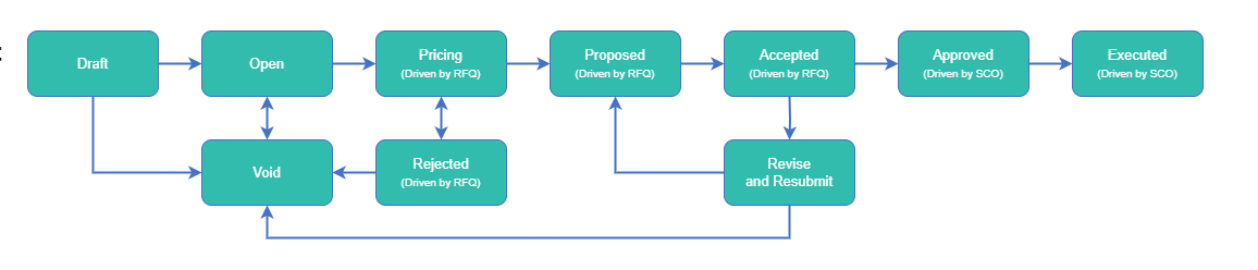

The following is a typical flow of statuses for cost PCOs:
Potential change orders have the following cost statuses:
- Open: When a PCO is set to Open, it formally enters into the system. All of its cost items are also set to open. You can now generate an RFQ, COR, OCO, or SCO, depending on the scope.
- Pricing: Proposed price is agreed to for the cost change. Cost items can no longer be added or removed.
- Proposed: Cost items can no longer be attached to the PCO.
- Accepted: The cost change is accepted.
- Approved: The cost change is approved.
- Executed: All parties have signed the cost changes.
- Rejected: You can revise and resubmit.

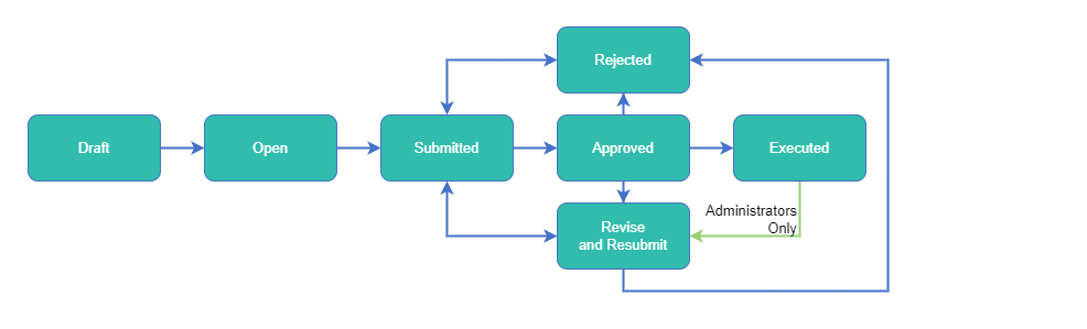

Typical OCO status workflow:
Owner change orders have the following statuses:
- Draft: During the creation state of an OCO.
- Open: When an OCO is set to Open, it formally enters into the system. You can now generate OCO documents.
- In Review: An active approval workflow is triggered.
- Submitted: Submitting the change order for approval activates this status. Cost items can't be added or removed. PCOs and RCOs can't be attached.
- Revise and Resubmit: One from the party hasn't accepted the change order and requested revision. Check what is required and submit revised change order. Only project administrators can set this status when the change order is already executed.
- Approved: The owner accepted the change order. You can generate an SCO.
- Executed: All parties have agreed to the change order.
- Rejected: Not accepted by the owner. You can revise and resubmit the OCO.

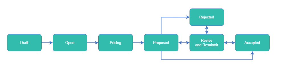

Typical RFQ status workflow:
Request for quotations have the following statuses:
- Draft: During the creation state of the RFQ.
- Open: When an RFQ is set to Open, it formally enters into the system. RFQ documents can be generated.
- Pricing: RFQ was sent to the supplier for pricing. Can add cost items and generate documents.
- Proposed: The proposed price is agreed upon for the cost change. Cost items can no longer be attached to the RFQ.
- Accepted: The change order is accepted. You can generate a SCO.
- Closed: Extra status, set when a request is closed.
