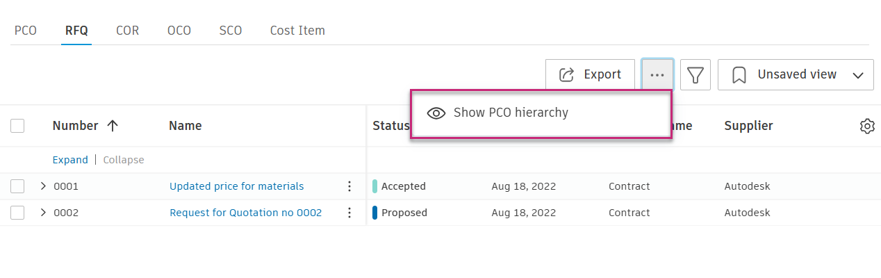

Navigating Change Orders with Hierarchy View
When working with multiple change order types for the same variation order, you may find it challenging to navigate between different change order numbers (PCO, COR, OCO, RFQ, SCO). The PCO hierarchy view feature helps solve this navigation challenge.
The hierarchy view can be toggled on/off in each change order tab (COR, OCO, RFQ, SCO) by clicking the hierarchy icon.
When enabled, related change orders are grouped together to show their relationships:
COR view: Groups CORs by their originating PCO
OCO view: Groups OCOs by both their related COR and originating PCO
RFQ/SCO view: Groups RFQs and SCOs by their originating PCO
Benefits of using hierarchy view:
Quickly find related change orders without scrolling through hundreds of entries
See the originating PCO number when viewing any generated change order (COR, OCO, RFQ, SCO)
Understand the source and relationship between different change order types
Navigate seamlessly between related change orders for the same change request
Example: If you're viewing an OCO and someone asks for the PCO number, the hierarchy view will show the PCO parent, eliminating the need to search by description across different tabs.

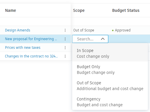

Change Order Scope Types
When creating change orders, the scope you select determines how the change order affects your budget and cost data. You can set the scope in the Change Order tab:
Navigate to the Change Order tab.
In the Scope column, select one of these options for each item:
In Scope: Updates only the Cost section of the table. The change order amount will increase your project's total cost but won't affect the budget.
Budget Only: Updates only the Budget section of the table. The change order amount will increase your project's budget but won't affect the total cost.
Out of Scope: Updates both the Budget and Cost sections of the table. The change order amount will increase both your project's budget and total cost.
Contingency: Updates both Budget and Cost sections. This option helps you track changes that use your contingency funds. It lets you distinguish between change orders that increase your overall budget and changes that simply use money you've already set aside in your contingency budget.
Tip: You can customize the names of these change order scope options in Change Order Settings to match your company's terminology.
