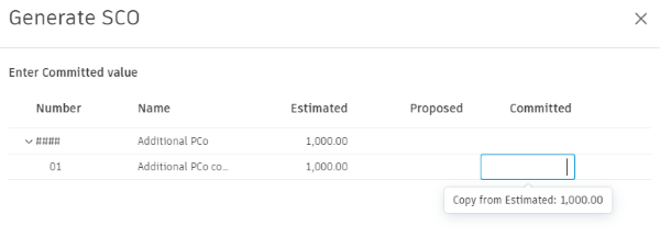

  5. Enter a committed value if necessary. You can copy cost item amounts from another column.
    Copy Cost Item Amount
    Tip: You can use a copy button on change order level as well.
  6. Click Generate.

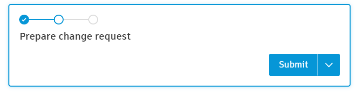

Your generated change order will show in the appropriate tab. Switch to the relevant tab and find newly created change order. Prepare a change request. To do that:
  1. Click the relevant change order item. The details panel opens.
  2. Set the status as Open.
  3. Enter a scope of work if necessary. For example, fill in information in the Owner or Supplier Details section, and add a Response Due date.
  4. In the Documents section, create a document package and add more attachments as required.
  5. Once your change order is ready to send, click Submit.
    Prepare Change Request

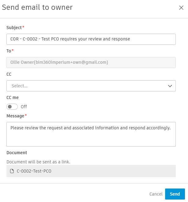

  6. Check the information in the pop-up window. You can change this information by closing this window and returning to the details panel of the change order.
    Send Email to Owner
    Tip: The owner or supplier contact from the PCO flyout is the default recipient. You can change the owner contact in the Company Setup setting. You can change the supplier contact in the flyout panel of the change request.
  7. Click Send.

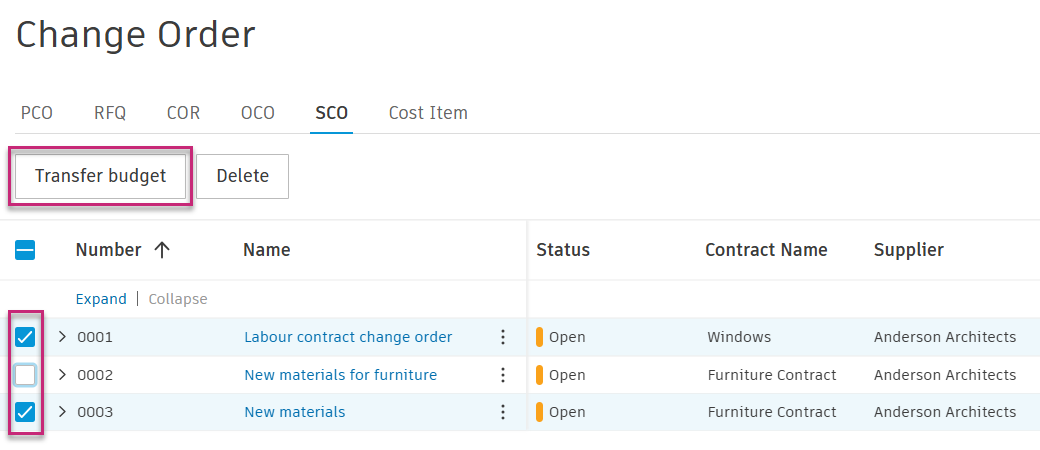

To create a budget transfer from an SCO:
  1. Go to the Change Order tab and select the SCO tab.
  2. You can create a budget transfer in several ways:
    • From an SCO: Click the More menu Vertical More Menu next to the SCO and select Transfer budget.
    • From a cost item: Open the SCO, find the cost item, click its More menu Vertical More Menu, and select Transfer budget.
    • From multiple items: Select multiple SCOs or cost items, then click Transfer budget in the batch actions.
      Batch Transfer Budget Example

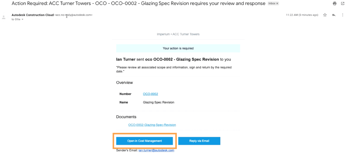

Receive and Respond to Owner Change Order Email
In the change order workflow, an email will notify an owner of the change order for review, if they have collaborate permission for change orders.
As an owner:
  1. Open the received email and select Open in Cost Management. When Cost Management opens, only the information pertaining to the owner will be visible.
    OCO Email

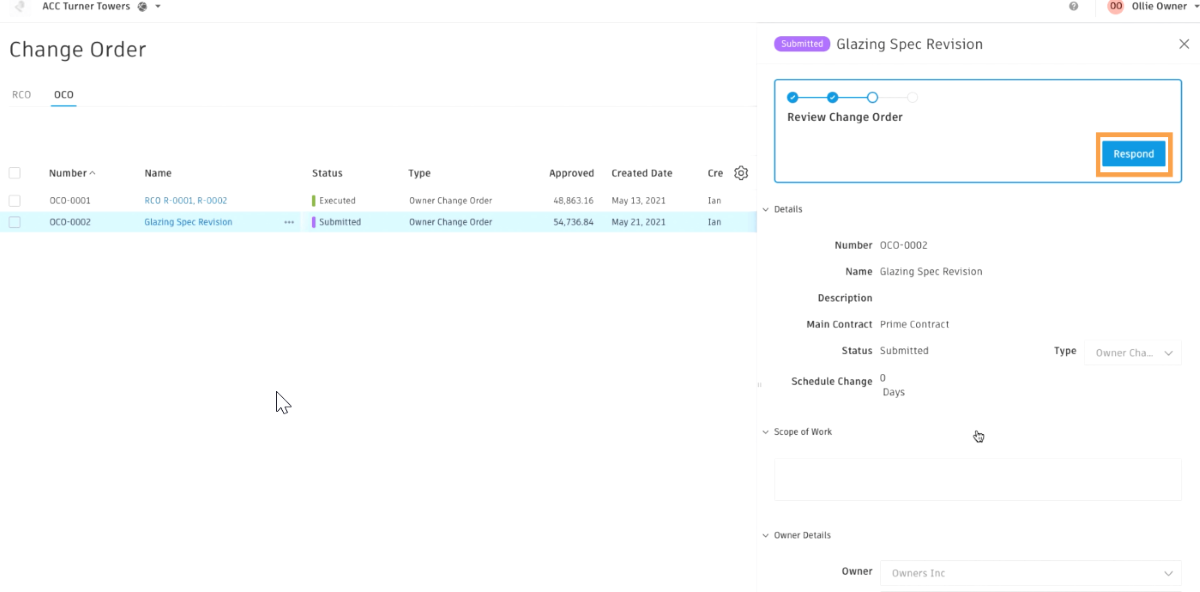

  2. Click the change order name to open the details flyout panel.
  3. Scroll to review details, including any documents. When collaborative access is assigned to an owner, you can review, accept, reject, or request a revision.
  4. Select Respond in the workflow bar.
    OCO Respond

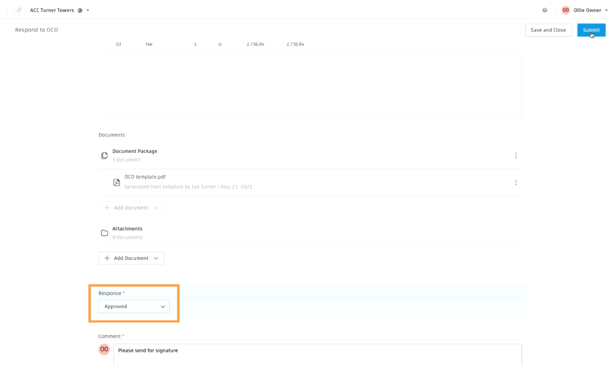

  5. Review the Scope of Work and attached documents. To add attachments, select Add Document.
  6. Respond by clicking the drop-down in the Response section and selecting Approved, Revise and Resubmit, or Rejected.
    OCO Response
  7. Include a comment before hitting Submit.
Once submitted, the general contractor will be notified.
