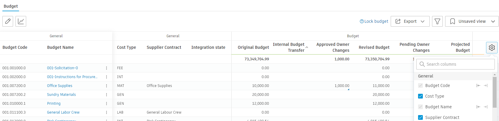

The tables in the Cost Management module can be difficult to deal with while extracting specific information. You can control the tables by snapping columns to the left or right, showing or hiding columns, changing the order of columns, or reset the default view.
You can access the table settings with the .
This short video shows the example of customizing the Budget table:
Note: The tab names seen in the video (for example, Income) are customizable within Services.
Snap Columns
  1. Hover over a column in the table settings.
  2. Use the icons to snap to the left or right .
  3. Click again or select Reset to restore the default view.
Note: The snapped columns remain in their original order.
Show or Hide Columns
  1. Select or deselect the column by clicking the box in the table settings.
  2. Select Reset to restore the default view.
Change Column order
  2. Click the handlebar on the left and drag the column to the desired location.
  3. Use Reset to restore the default view.

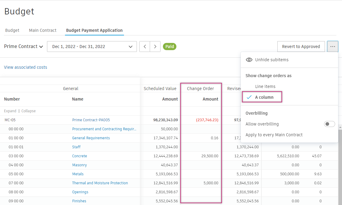

Column Mode
The column mode presents change orders in a column.
This option is available in the Budget Payment Application, Main Contract, as well as in detailed view of Contract SOV, Cost Payment Application, and Contract.
To show change orders as columns, click the three-dot menu and select the view.
Learn more about Change Orders.
