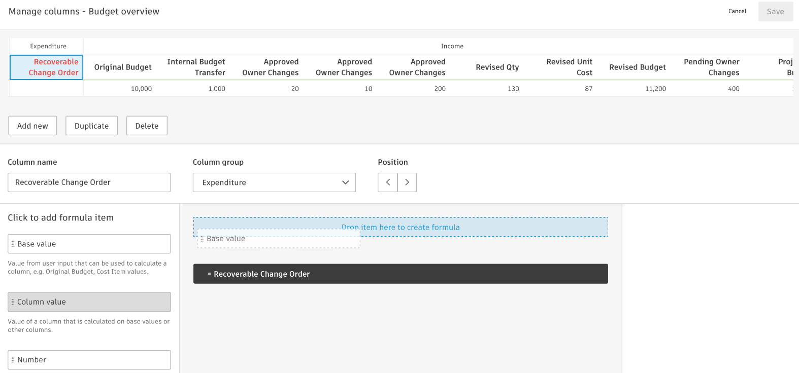

For example, creating a column next to Approved Change Orders in the Cost group titled Recoverable Change Orders shows what will be paid for by the owner. To do so:
Click
Select Cost Management from the left.
Select the Budget or Cost tab.
Expand the Budget Overview Columns card.
Click Manage.
Select Add New.
Update the column name.
Choose the column group.
From the left side panel, drag a formula item and drop it to create formula.
On the right side panel, select the value type and enter a value to preview.
Update the column position and visibility option.
Select Save.
You have created the Recoverable Change Order column. There are many possibilities and combinations to create columns. See the Custom Calculated Columns Equations section to see helpful tips and tricks on how you can create equations to suit your company's needs.

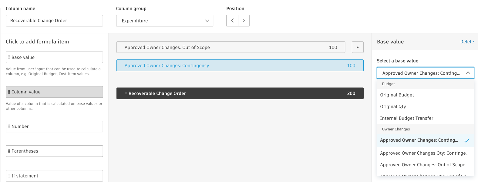

You can drag the following items to create the equations that define the output in the column:
Project Value: The drop-down menu on the right allows for the selection of raw values from the project to be used. For example, the status and scope are included for budget items.
Existing Column: The drop-down menu on the right allows the column to have the exact value used.
Number: Allows you to enter a specific number in the area to the right.
Parentheses: Allow for any necessary order of operations that you can drag other values into the parentheses.
If Statement: Allows you to create conditions for information to populate the column. For example, calculating the variance by the larger value projected budget minus actual cost or projected budget minus projected cost.

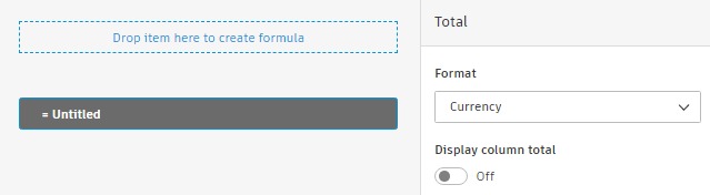

Addition is the default math operator when a value is dragged into the math area. Click the operator and use the drop-down menu on the right to change the operator. Supported operators:
The following animation shows the creation of a custom column using If Statements:
