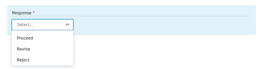

Response Options
Reviewers can respond with Proceed, Revise, or Reject. When a reviewer selects a response, a description is displayed to explain the outcome. The description varies based on the workflow type, the current step, and the Action upon completion setting:
Response options dropdown
Response Condition Description
Proceed Last step AND Action upon completion = Submitted Multiple reviewers: The item will be sent to the Owner once all required reviewers respond with 'Approve'. Single reviewer: The item will be submitted to the owner, architect and collaborators.
Proceed Last step AND Action upon completion = Approved Multiple reviewers: The item will be approved once all required reviewers respond with 'Approve'. Single reviewer: The item will be approved.
Proceed Not the last step The item will be submitted for the next review step.
Revise N/A The item will be sent back in the Revise and Resubmit status.
Reject N/A The item will be sent back in the Rejected status.
Note: The Reject option is available for COR, OCO, and SCO workflows. It isn't available for Budget Payment Application workflows because there is no Rejected status for budget payment applications.
