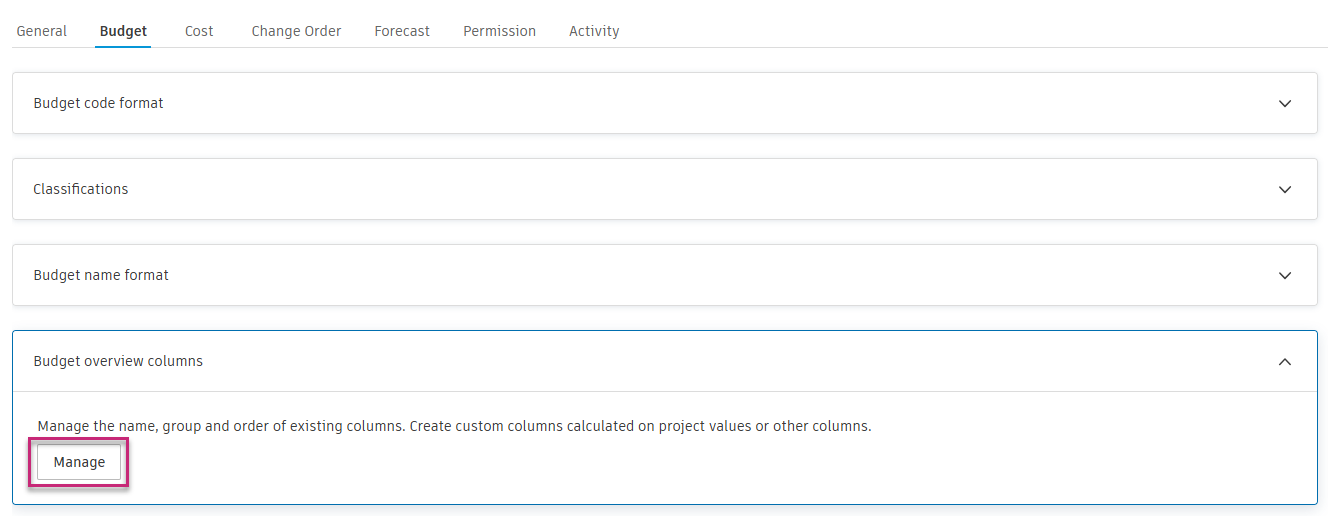

  4. Expand Budget Overview Columns or Contract Overview Columns, then click Manage.
    Budget overview columns card expanded with Manage button in Budget settings

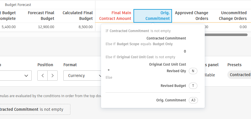

Tip: Hover a column header in the budget or contract overview to preview its formula. See Budget and Contract Tables for default column definitions.
Orig Commitment column header tooltip showing default if-else formula logic

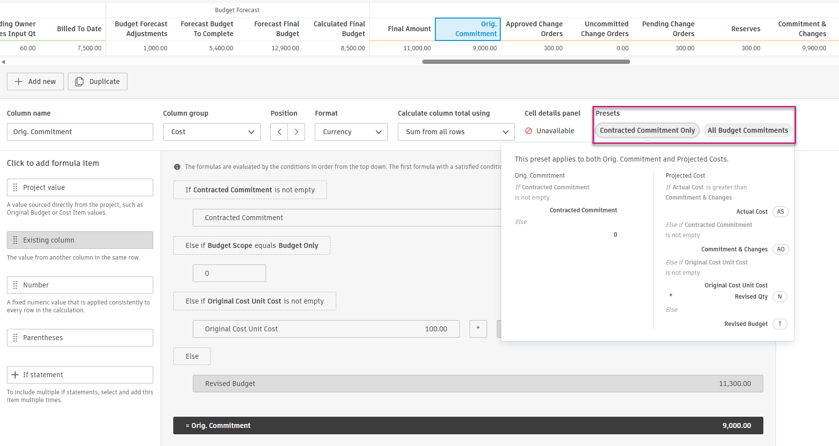

Use presets
Some system columns offer Presets that reconfigure if/else logic in one click.
Preset Applies to What it does
Contracted Commitment Only Orig. Commitment, Projected Cost Uses Contracted Commitment when present; otherwise Orig. Commitment is 0 and related logic moves to Projected Cost so day-one variance can stay at zero.
All Budget Commitments Same columns Uses the broader default commitment rollup.
Gross (includes retention) Actual Cost Includes retention in actual cost.
Net (excludes retention) Actual Cost Excludes retention from actual cost.
  1. Select a preset.
    Contracted Commitment Only preset selected with tooltip showing Orig Commitment and Projected Cost logic

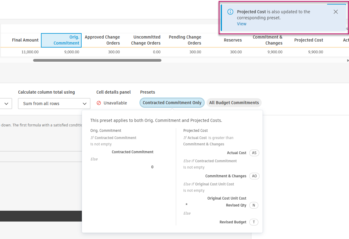

  2. If Cost Management updates a linked column (for example, Projected Cost), review the notification and open the related column if needed.
    Toast notification that Projected Cost was updated to match the selected preset
Tip: A preset can apply different if/else logic to more than one column. Use the preset tooltip to compare Orig. Commitment and Projected Cost before you save.

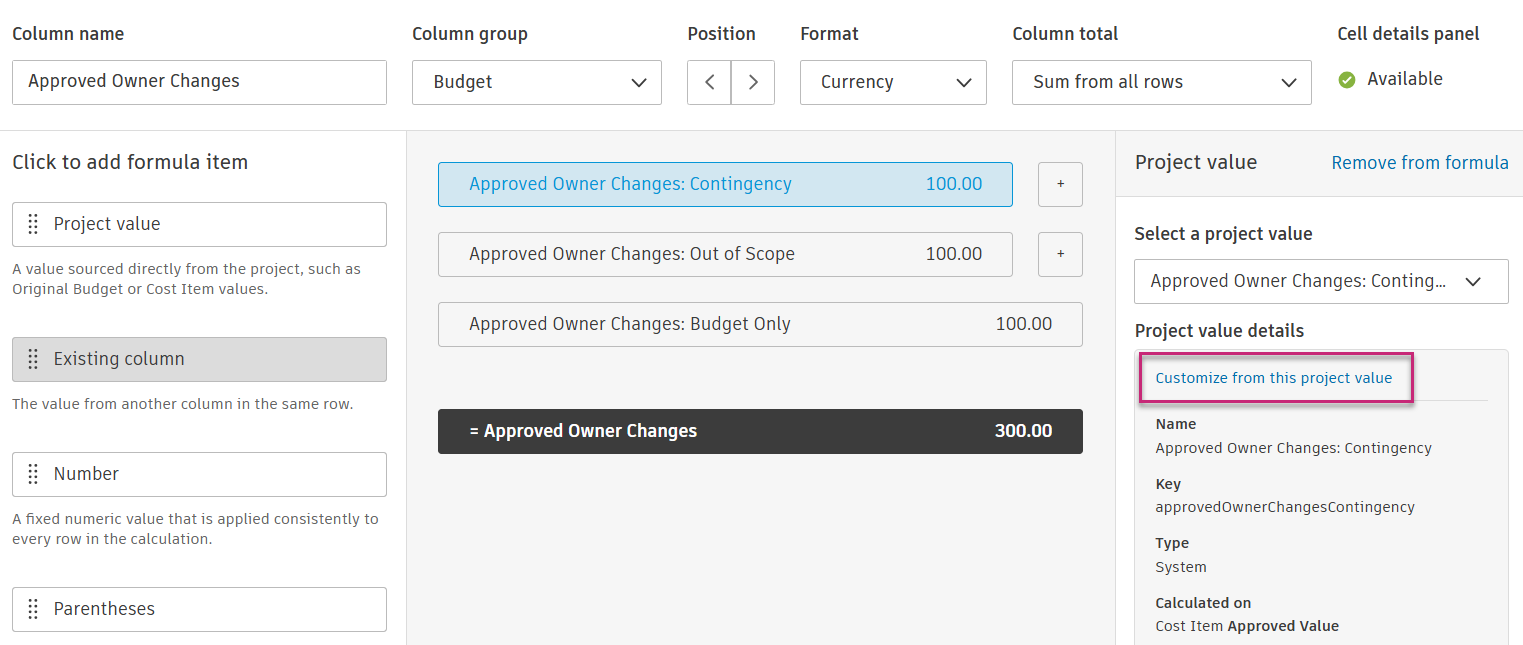

  1. Open Manage columns in Settings, select a column, and open its formula.
  2. In the formula, select a system Project value.
  3. In the details panel, click Customize from this project value.
    Customize from this project value link on a system project value in column settings

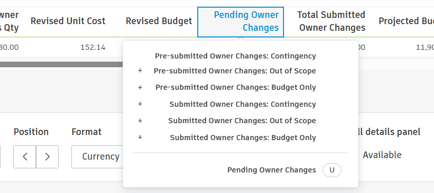

The system Pending Owner Changes column sums pre-submitted and submitted owner changes across Contingency, Out of Scope, and Budget Only scopes. See Budget and Contract Tables for default definitions.
Pending Owner Changes column formula showing pre-submitted and submitted owner change project values

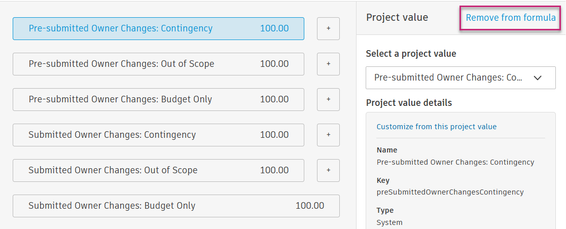

Create an Accepted owner changes column
  1. Open Manage columns in Settings, select Pending Owner Changes, and click Duplicate.
  2. Rename the column (for example, Accepted Owner COR).
  3. Remove all Pre-submitted Owner Changes items from the formula. Keep the Submitted Owner Changes items for each scope.
    Accepted Owner COR column formula with pre-submitted owner change items removed
  4. For each remaining Submitted Owner Changes item, click Customize from this project value.
  5. In Create custom project value, set Budget Status to Accepted only. Adjust Scope and Change Order Type if needed, then click Save.
  6. Repeat for each scope (for example, Contingency, Out of Scope, and Budget Only).
  7. Confirm the formula sums the custom (copy) values.
  8. Click Save.
