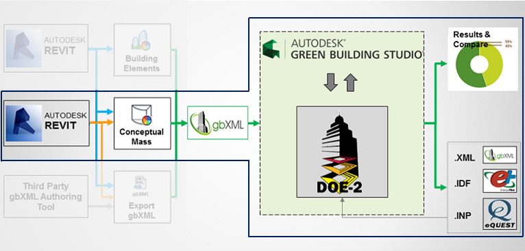

Quick start on process of building energy simulation using conceptual mass in Revit.
Energy Analysis for Autodesk® Revit® using conceptual masses is intended to provide insight into the role of building form (size, shape, orientation, glazing percentages, shading) and materials on building energy use from the earliest stages of the design process.
The following instructions describe how to perform an energy analysis using conceptual masses in Revit. Use these instructions to quickly create a baseline simulation that uses default energy settings. Then see the Energy Analysis using Conceptual Masses - Detailed Workflow to learn how to modify the conceptual mass model and its energy settings to refine the analysis.

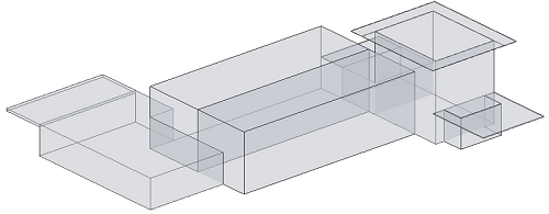

Create a mass model.
You can load a mass family into a project for simulation or create an in-place mass directly in a project. See Massing Studies. |

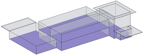

Add mass floors.
In the project environment, select the mass model, and add mass floors. |

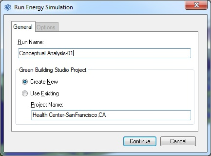

Name the analysis and specify the Green Building Studio project.
In the Run Energy Simulation dialog, specify a name for the analysis, and select whether to create a new or use an existing Green Building Studio project. Then click Continue. (Choose a name that is descriptive of the model and energy settings, and ensure that the Project you’re assigning the run to has the proper location and building type settings.) |

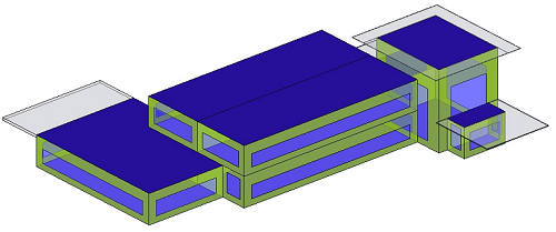

Simulated elements display.
The current view displays mass zones and mass shades, and it temporarily dims elements that are not included in the analysis. |

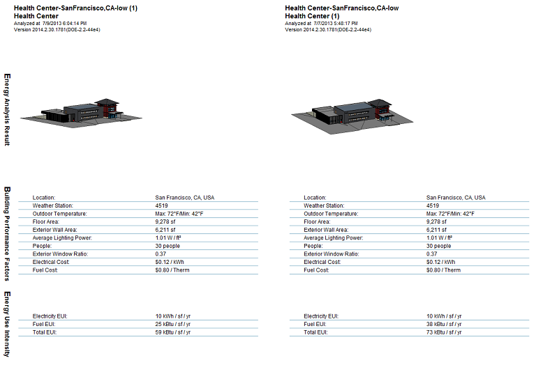

Review the simulation results.
In the Results and Compare dialog, view the analysis results. Tip: Use the Settings tab to select the charts to include in the results and to configure the display of energy analysis data on the Results tab. |
Make changes, simulate, and compare.
Modify mass model and energy settings as needed. Then repeat steps 5-9 to run a simulation on the modified model. For a side-by-side comparison of simulation results, select multiple analyses and click Compare on the toolbar. |
