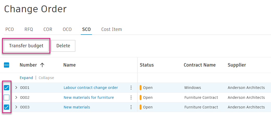

Create a Budget Transfer from SCO
Project administrators and members with both Budget and SCO full control permissions can create internal budget transfers directly from SCOs. This is useful when you need to move money from one budget item to another to pay for supplier change orders without requiring extra approvals.
To create a budget transfer from an SCO:
  1. Go to the Change Order tool and select the SCO tab.
  2. You can create a budget transfer in several ways:
    • From an SCO: Click the More menu Vertical more menu icon next to the SCO and select Transfer budget.
    • From a cost item: Open the SCO, find the cost item, click its More Vertical more menu icon menu, and select Transfer budget.
    • From multiple items: Select multiple SCOs or cost items, then click Transfer budget in the batch actions.
      Batch transfer budget example
