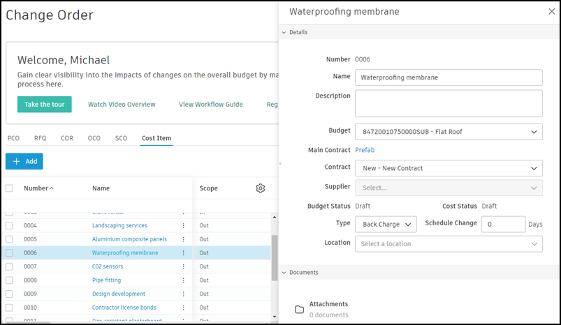

Click the Change Order tool from the left navigation.
Switch to the Cost Item tab.
Click Add.
Enter a name for the cost item.
Select a Budget Code from the drop-down list.
Enter an estimated price.
Select a Location for the cost item from the location breakdown structure.
Select the checkbox next to the cost item.
Click Assign.
Select a PCO from the PCO drop-down list.
Tip: After cost items are added, you can edit the items by clicking the budget item and using the panel on the right. You can make these edits from both the Cost Item tab and the PCO tab.

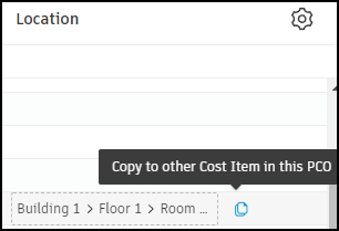

Copy a Location of a Cost Item
If a location for one cost item applies to other cost items within the same PCO, you can copy the location. To do so:
From the PCO tab, hover your cursor over the Location field of the cost item assigned to a PCO.
Click to copy the location to the other cost items in the PCO.

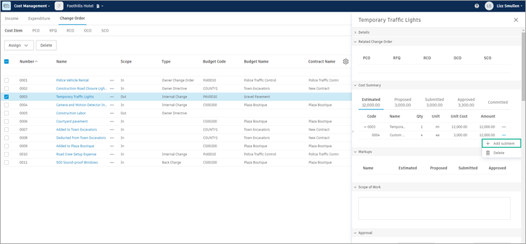

To add a cost subitem:
Click a cost item name to open the details panel.
Select a tab in the Cost Summary section.
Note: The tab you select determines which column in a table a subitem total appears in.

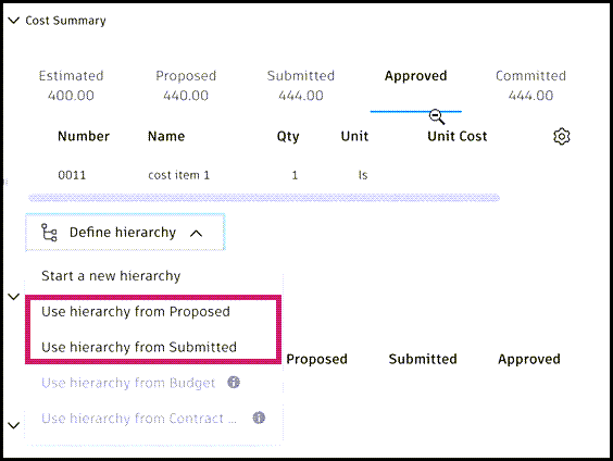

Click the Define Hierarchy menu.
Choose between:
Start a New Hierarchy: Enter the Code, Name, Quantity, Unit, and Unit Cost for a subitem.
Use Hierarchy from Budget: This option is available when the cost item is linked to a budget. Select the checkbox for SOV to use and then click Save.
Use Hierarchy from Contract SOV: Select the checkbox for SOV to use and then click Save.
Note: When an Estimated, Proposed, Submitted, Approved, or Committed value is already provided, you can use its hierarchy by selecting Use hierarchy from ..., for example, Use hierarchy from Proposed.
To add more subitems:
Hover your cursor over the parent or subitem.
Click the More menu.
Click Add Subitem.
Enter the data for the new subitem.
As required, switch between the remaining tabs, click the Define Hierarchy menu, and select one of the available options.

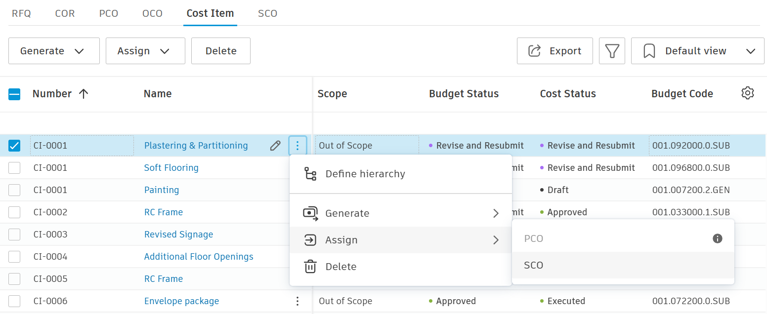

To assign cost items to an existing SCO from the Cost Item tab:
Select the checkbox next to one or more cost items.
Click Assign, and then select SCO.
In the Assign to SCO dialog, select the target SCO from the Name drop-down list. Only SCOs that match the selected cost items' contract and status appear.
Tip: Scope of work and generated documents on the target SCO may need to be updated after you assign cost items to it.
You can also assign a cost item to an existing SCO from the PCO tab — select the cost item, open the More menu , choose Assign, and then SCO.

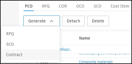

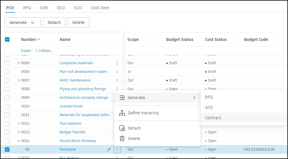

To generate a contract from a cost item:
Switch to the PCO tab.
Click the checkbox to the left of a cost item within a PCO.
Click Generate, and then Contract.
Tip: You can also click the More menu to the right of a cost item. Choose Generate, and then Contract.
