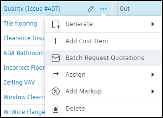

Batch Request Quotations
In addition to generating an individual RFQ, you can batch-request quotations from a PCO. A batch-request quotation is useful when a change occurs, and it is unclear who might be affected by this change. To reduce the risk of missing anyone, send a batch request to all suppliers to let them indicate whether they are affected or not and keep a record of their response.
To create a batch request:
  1. Click the Change Order tool.
  2. Click the PCO tab.
  3. Click the More Vertical more menu icon menu of a PCO and choose Batch Request Quotations.
    Batch request quotations option in the PCO More menu
  4. You can add a filter for contract type in the newly opened window.
  5. Select one or more suppliers.
  6. Optional: In CC, select project members who should receive a copy of the batch request email.
    Batch request quotations window with contract type filter, supplier, CC, message, due date, and attachment fields
  7. Write a message to be included with the request.
  8. Select a Due date.
  9. If necessary, choose Attachments to include.
  10. Click Send.
Placeholder cost items are generated for each supplier and are shown in parentheses. Suppliers can respond by saying no impact or can propose a quotation.
Placeholder cost items shown in parentheses in the PCO table
The placeholder cost items will be converted to regular cost items when a quotation is proposed.
