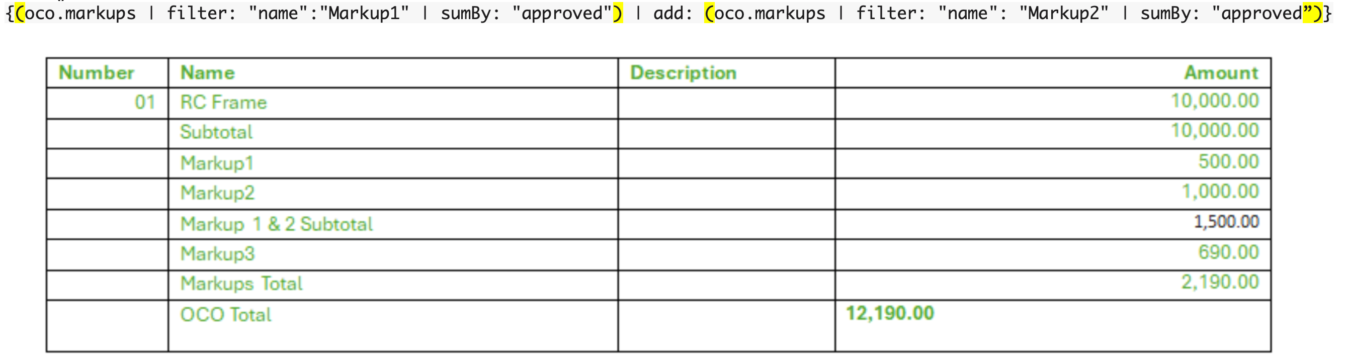

How can I add work items subtotals and markup subtotals for cost items?
Scenario: You're creating a change order document (for example, OCO) and want to have two separate tables within. One for regular cost items with a subtotal and the second for markup cost items. You want to add total change order pricing as well. How to do that? Here's an example of used variables in a document:
OCO document template showing separate tables for work items and markup subtotals

Example 3: Calculate the combined total of specific markups (e.g., Markup1 + Markup2).
Use the filter function with sumBy and add to create subtotals for selected markups:
{(oco.markups | filter: "name":"Markup1" | sumBy: "approved") | add: (oco.markups | filter: "name": "Markup2" | sumBy: "approved")}
This filters markups by name, sums their approved values, and adds the results together. Use this pattern to create custom subtotal rows in your document templates, such as "Markup 1 & 2 Subtotal".
Generated document showing markup subtotal calculation with Markup1, Markup2, and combined Markup 1 & 2 Subtotal row
Tip:
The sumBy function is particularly useful when you need to show calculated totals that aren't directly available as individual variables.
