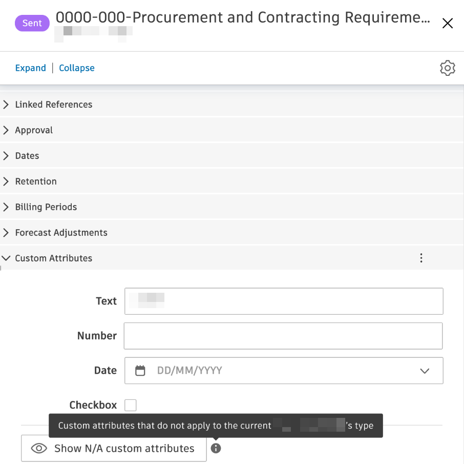

Not Applicable and Invalid Custom Attributes
When working with contracts, you may encounter custom attributes in two states:
In the contract details flyout panel, the Custom Attributes section provides options to manage these attributes:
Show custom attributes and the notification tooltip
Tip: When filtering or grouping by custom attributes, valid data and invalid data appear in the same filter or group. Empty data and N/A data appear in the same filter or group. This helps maintain data integrity by allowing you to identify and clean up custom attribute values that are no longer relevant due to contract type changes.
