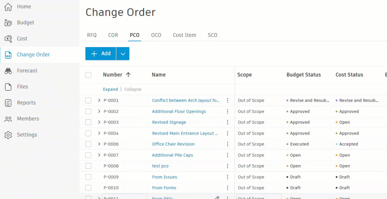

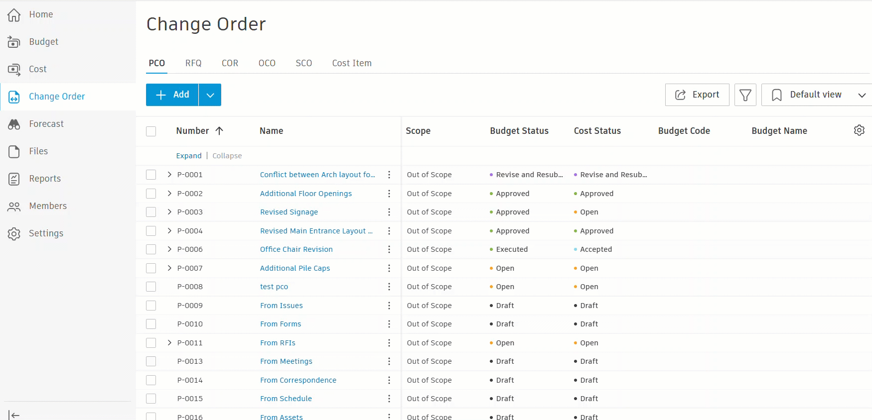

See the following animation to learn how the change order tabs can be reordered:
Animation showing how to reorder change order tabs in Forma Build
See the following animation to learn how the change order tabs and tools can be renamed:
Animation showing how to rename change order tabs and tools in Forma Build
Note: The tab names seen in the videos (for example, Income) are customizable within the Settings tool.

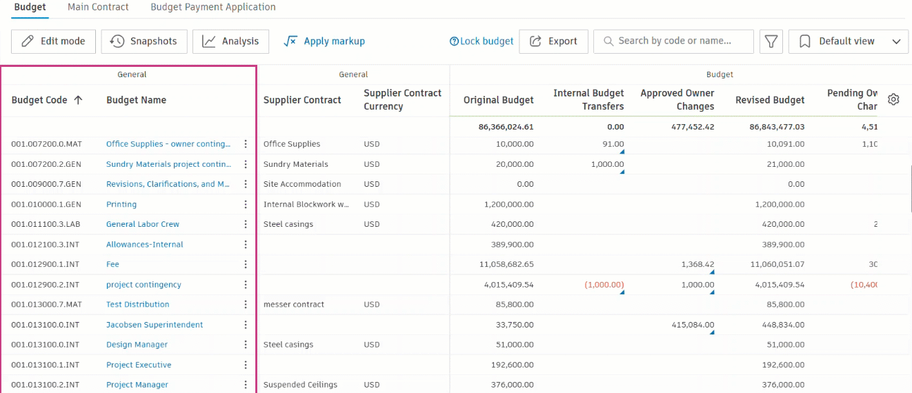

Snap Columns
To snap columns:
  1. Hover over a column.
  2. Use the icons to snap to the left or right Snap column icon.
  3. Click again or select Reset to restore the default view.
Note: The snapped columns remain in their original order.
