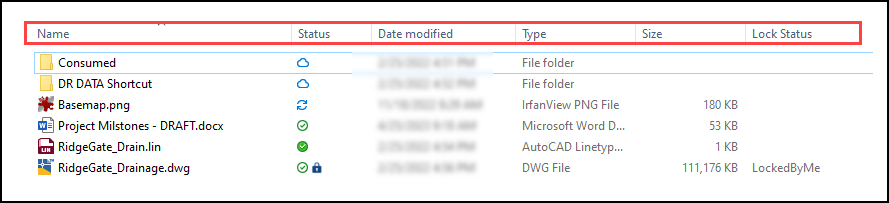

You can view project folder and file attributes in File Explorer. Attributes display as column headings and values are populated where the information is available.
View Attributes
The default attributes that display are:
Display attributes

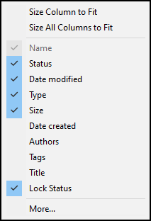

In addition to the default attributes, you can right-click on the column header and select extra attributes to display in your current folder.
Attribute Value Selections
