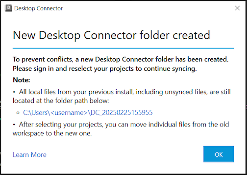

Starting from version 16.13, if you reinstall Desktop Connector and still have files from a previous installation on your device, the old Desktop Connector folder will be renamed to prevent conflicts with the new installation. This renamed folder does not sync with the cloud.
To sync the workspace from your new installation with the cloud, simply sign in and select your projects.
Important: All local files from your previous installation, including unsynced files, will remain on your device in the renamed folder. These files haven't been synced to the cloud since Desktop Connector was uninstalled. Because of this, be careful to avoid overwriting newer versions of the files if you choose to move any into the new Desktop Connector folder.
New folder created dialog
